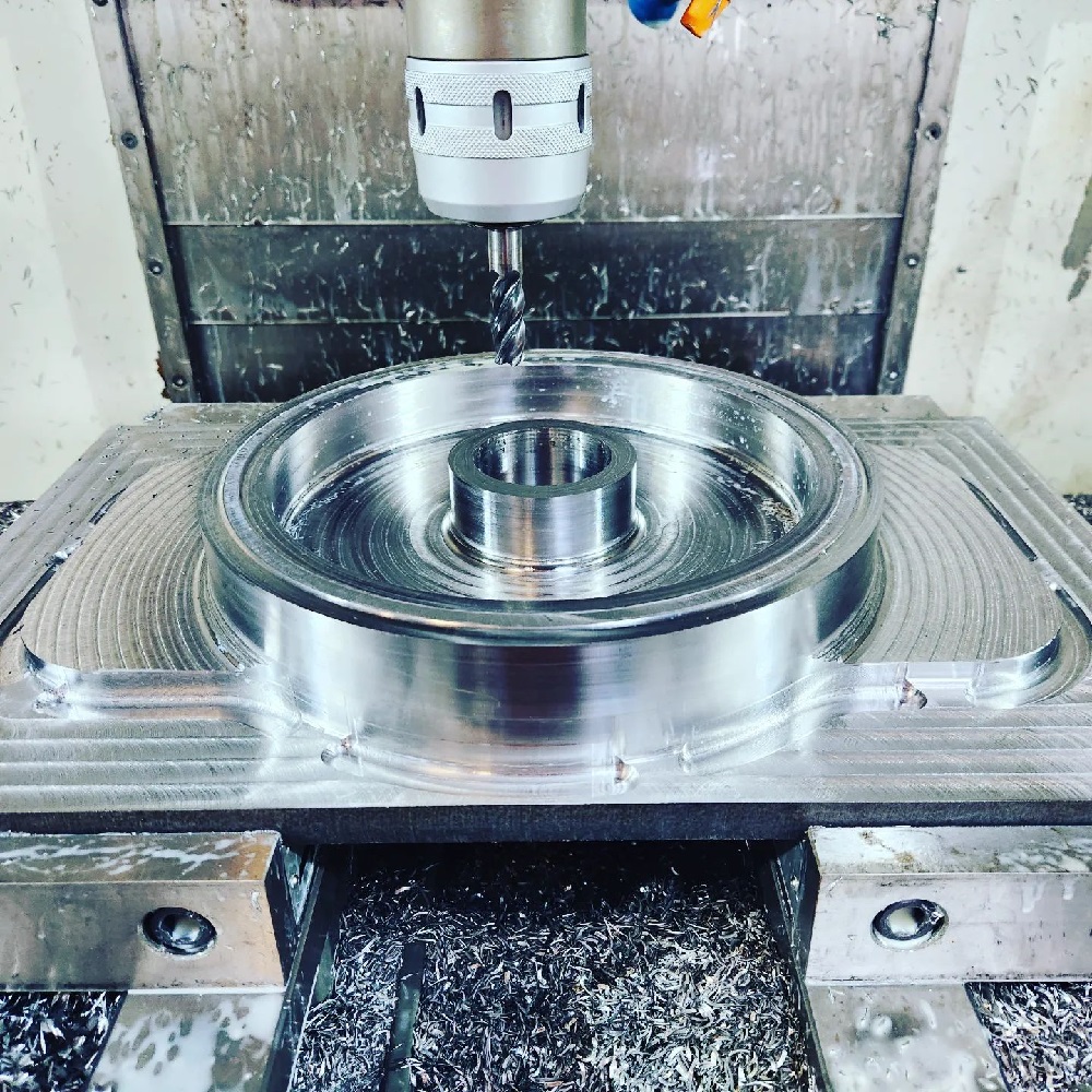

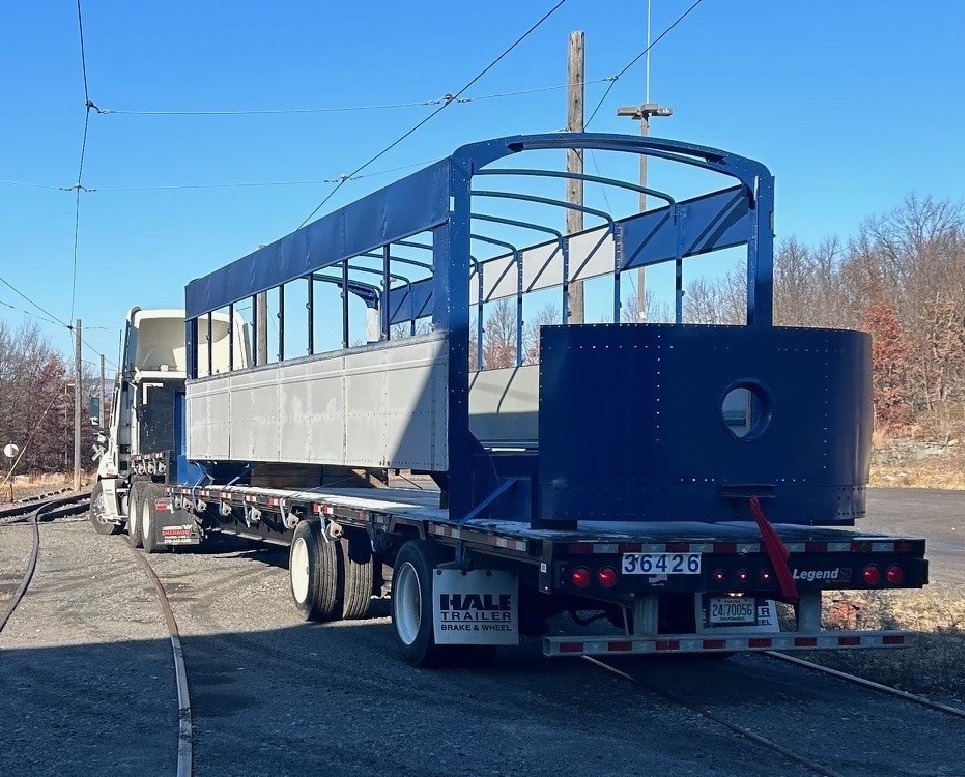

Hello, I wanted to post an update on Scranton Transit trolley #505, our 1929 Osgood Bradley Electromobile. The car body recently returned to Scranton after several years in Honesdale. This latest phase saw the completion of approx. 100 fabricated parts, including the installation of flooring supports and sill troughs for the electrical.

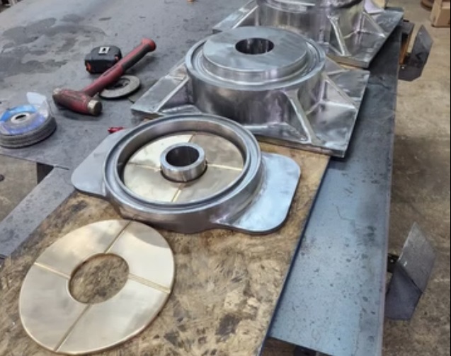

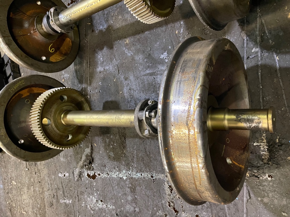

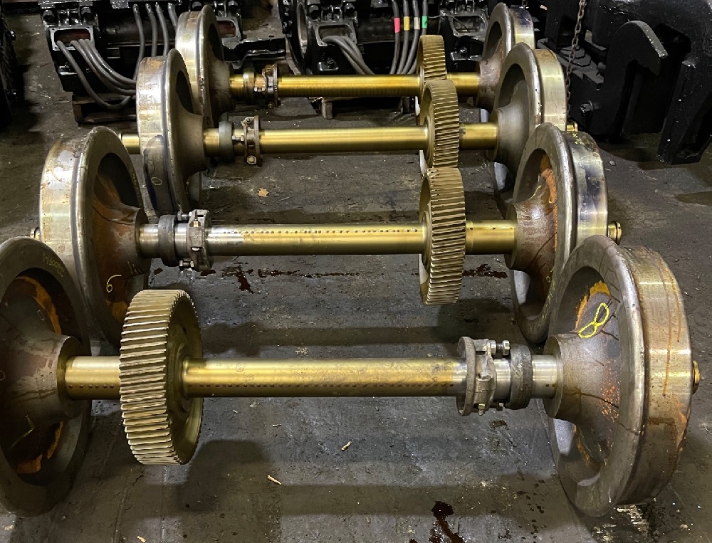

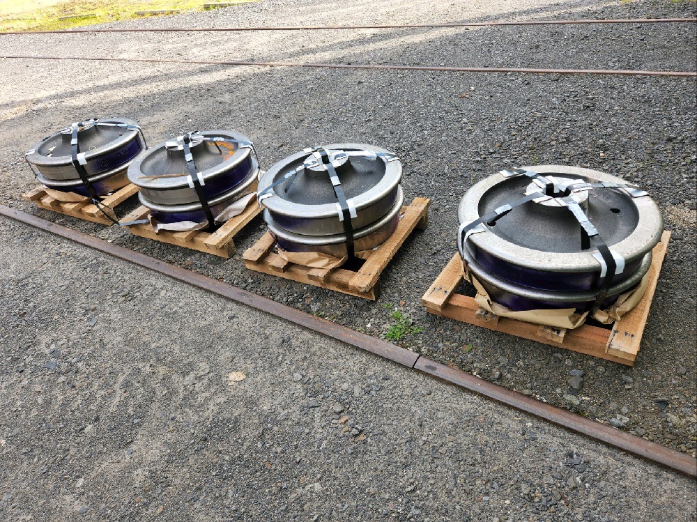

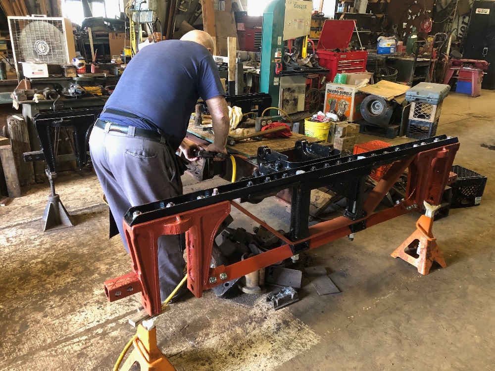

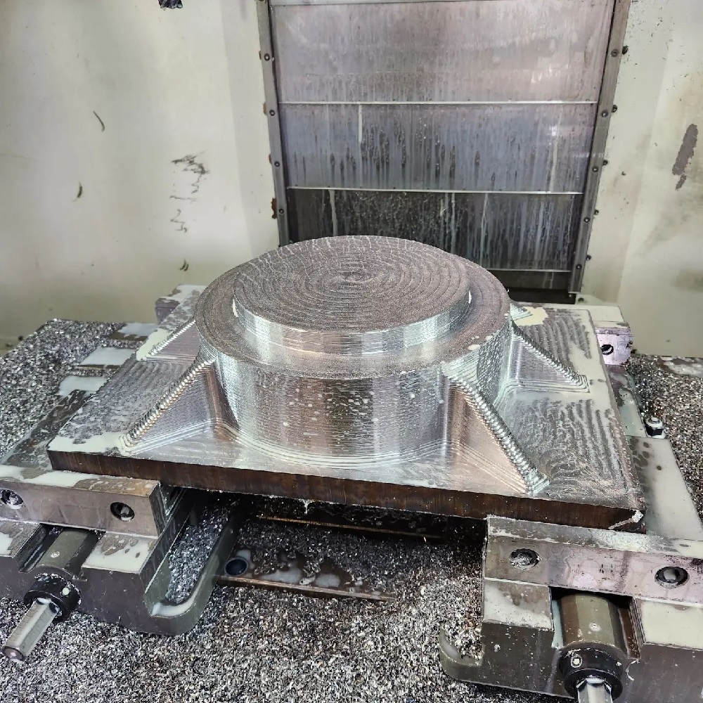

Restoration on the car’s original trucks is progressing, including new 26” wheels from McKees Rocks Forgings and axle work by Lyons Industries. Our volunteers spent a good chunk of 2023 rebuilding the truck frames. The trucks will rejoin the car body in early 2024 thanks to a new pair of CNC’d bolster bearing assemblies.

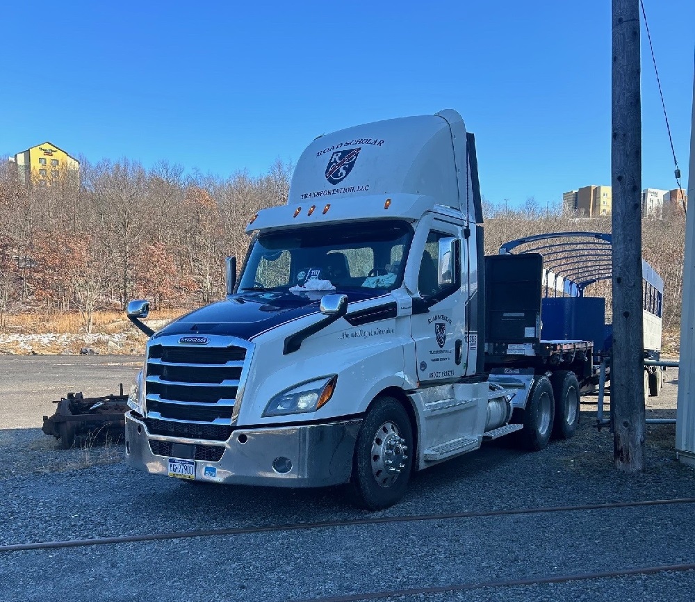

Thanks to Road Scholar Transport for the lift
New wheels from McKees Rocks Forgings.
Wheel and axle work by Lyons Industries.

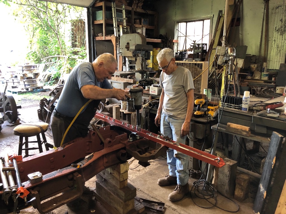

Volunteers Ron Walker and Dick Berk tackle the truck frames.

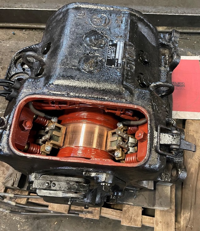

First pair of motors are done. Thanks, Lyons!

Thanks, Matt. It’s hard to believe those motors were sitting outside for the better part of 70 years!

I love those CNC milled center plates.
Question on the WH510 motors: did you have to rewind the armatures, after they sat outside for so long? What about the commutator?
 Post subject: Re: Update on Scranton Transit #505
PostPosted: Sun Jan 21, 2024 2:45 am
Joined: Sat Nov 30, 2013 3:17 am
Posts: 89

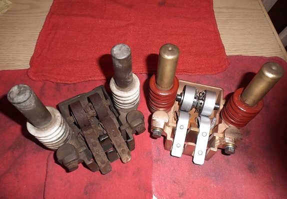

The armatures tested ok but needed new bearings and to be reinsulated. Fields and interpoles had to be rewound. If the comms needed anything it wasn't notable enough to list on the work order. The brush holders needed a lot of help.
The two motors from the second truck seem to be a little worse for wear, we'll know the full story soon.
