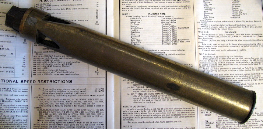

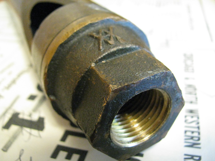

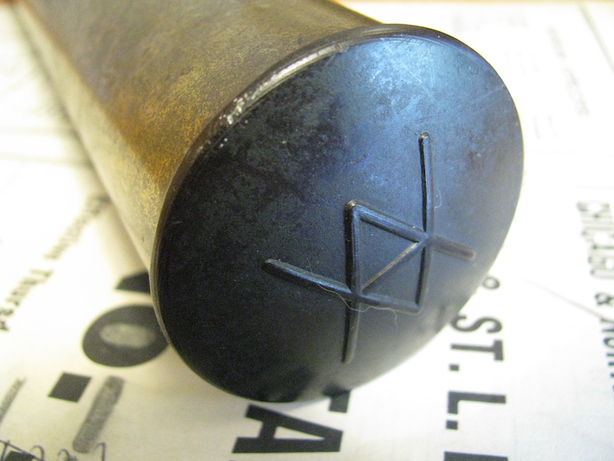

I have always been under the impression that examples like this bakelite-capped, no partition one were prototypical latter-day Westinghouse Trombone whistles.
 Post subject: Re: Operating valve for "trombone" whistle
PostPosted: Mon Sep 05, 2022 4:43 pm
Joined: Wed Aug 31, 2022 8:56 am
Posts: 86
Overall view:
