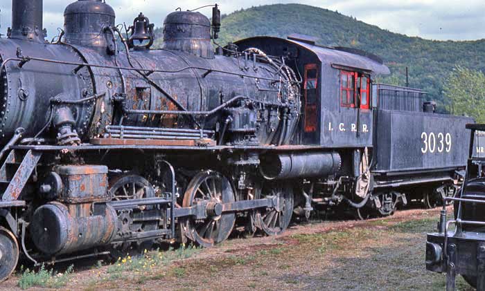

J3a-614 wrote:
I wonder how many other preserved locomotives have them besides the ones mentioned so far?
Illinois Central 2-6-0 3039, now at IRM.
http://www.vistadome.com/trains/steamtown/icrr3039.jpg
