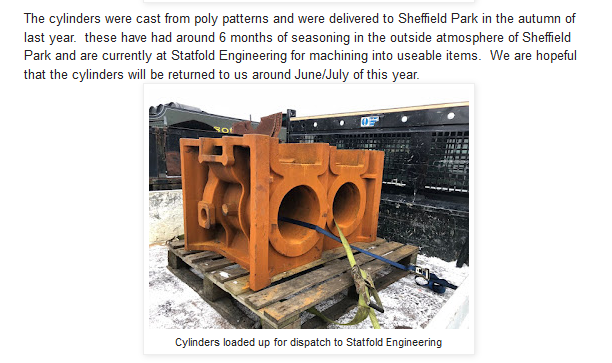

Something I am curious about is if they will use cast iron or steel for the new driver. In the UK, they are big on the idea of "seasoning" new iron castings to relieve internal stresses, before proceeding to machining and installation. Typically, this means placing the new castings on a pallet somewhere outdoors and forgetting about it for a period of time. If a a cast iron driver is made and a similar process is followed, then surely the time to replace the driver is more than a half year?
Of course, missing in this discussion is when they realized the driver was cracked, and when they initiated the replacement process. Potentially, they are already half way finished to producing a new driver casting.
