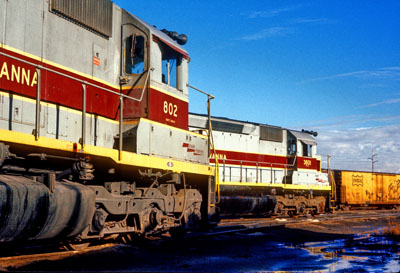

The EL had some special clearance features on their EMD SD locomotives:
Unusual air horn mounting in front of the right side number boards
Low profile fans
Low profile inertial filter compartment hatch
Low profile truck suspension components
As participants at another discussion asked me why these were required, I am sharing that information here. These features were needed due to clearance problems on the DL&W lines in New Jersey, particularly low wire on the electrified lines in hot weather, at Summit Station and some other locations. The strike zone was directly down the centerline of the locomotive. We had a clearance alarm at the Marion Shop to monitor the height of roof fixtures.
PC

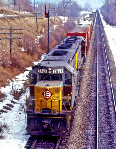

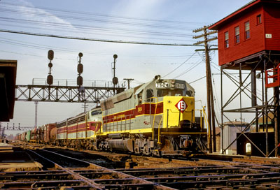

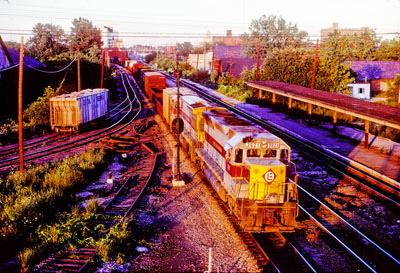

Here are down-on views showing the low profile features. Compare the SD45 fans with the GP35 fans in the top photo.
PC
ELRR-3621-SD45-TWILIGHT-MARION-OHIO-JUL74-P-COOK.jpg [ 98.19 KiB | Viewed 5707 times ]

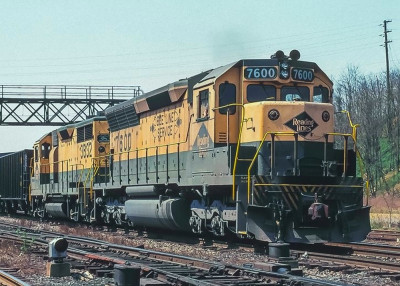

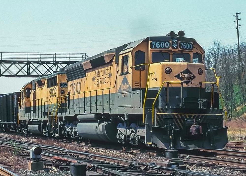

They had to raise the frames on the 45's to get those big fuel tanks under there...
