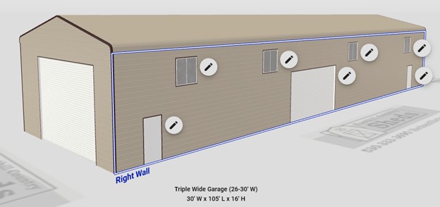

Niles Canyon Railway needs an additional shop building (don't we all?). Basic requirements are:
Concrete pad approx. 110' long x 28'-30' wide
Thru track on centerline
Pad includes reinforcement along entire length, suitable for 35-ton capacity Whiting portable car jacks
Pad periphery suitable for attaching a lightweight steel prefab bolt-together shop building
Ground is currently well-packed crushed rock + Adobe clay soil, on level area
Optional service pit between rails
Rather than "reinvent the wheel" here, does anyone have drawings for a concrete pad available that could serve as the basis for our requirements? This would expedite getting a local Professional Engineer to modify the drawings as needed, and get a building permit approved. I'd be glad to pay reproduction costs, and/or other fees, to jumpstart this.
Thanks! - Doug Debs
cell 650-704-1487
<dougdebs2472@yahoo.com>
P.S.: Sketch below is just a rough idea of what is needed. Ventilation fans, window & skylight sizes and locations, etc are TBD.
