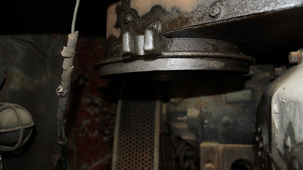

Hey y’all!
Hoping someone can help me here. I have poured all over the 090 and 300 catalogs for the roots blower filter on an SW1 and I can’t find it to save my life. It’s driven me bonkers for the last hour and a half too. Could someone help me with my quest?
The reason I am seeking this part is, I did an initial inspection on an SW1 that our organization may be acquiring. It needs some work, nothing too crazy, however this part was the only missing piece.
I appreciate any help that can be offered.

Sorry, I forgot the photo of the location for the part in question.
Gary Rodriguez
SA, TX
File comment: Photo of the location of the missing filter canister(?).
 Post subject: Re: EMD SW1 roots blower filter
PostPosted: Fri Apr 26, 2024 11:22 pm
Posts: 2130
Original circular blower mounted filter was usually 8050846.
PC
PostPosted: Sat Apr 27, 2024 12:09 am
Posts: 2130
Catalog 301, List A378. I doubt EMD has any, it would be a scrap/salvage item now.
An SW1 uses one filter, an NW2 uses two of them. Farr marketed a rectangular replacement unit many years ago. If you want to adapt a currently produced air filter a 6-567 engine requires about 1800 CFM air flow.
PostPosted: Mon Apr 29, 2024 9:08 pm
Posts: 473
I'd suggest doing a little shopping for the adapter to run a Clark "small baggie" filter. I can't remember if that's the EG-1 or EG-2 part number. Both our SW-1s have them. Fairly common and available in an extended life version as well.
PostPosted: Tue Apr 30, 2024 11:30 am
Posts: 270
I scrapped/parted out an EMD SW9 that had an air filter that used a round long heavy equipment filter you could just purchase at any Napa store.
The SW9 had 2 of these.
A lot of the older locomotives originally used an oil bath filter.
