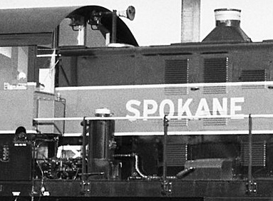

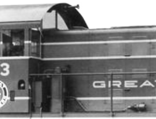

Install a real or reproduction Vapor Heater (pic) for the cooling water. Remove the kerosin
burner for an electric heating element. Heat the cooling water and the fuel tank to 150 F.
Now use vegetable oil (waste or pure) as fuel whatever you get easy to and finished is the
almost zero emmision lokomotive. (I prefer Jathropa Oil - lowest ignition temperature -
highest cetan rating).

"Mio" is NOT an abbreviation for million. What would heating the cooling water doe for emissions?
 Post subject: Re: Clean Diesel Upgrade for an ALCO 539T ???
PostPosted: Thu Apr 04, 2024 4:35 pm
You heat the cooling water and circulate it through the block before starting, so the cylinder walls come up to 'operating' temperature and don't quench the injected fuel as compression further heats the wall metal. Lower amounts of white smoke at starting; you can further reduce it by crabking the engine a few revolutions with the fuel rack shut off.
You heat the oil for the usual reasons we use pan heaters on diesel trucks. Just as with a coolant heater, the oil heater is recirculating or on the 'bypass' circuit with controlled heat rise in a pass, so the oil isn't coked or degraded even though brought to and then kept at close to operating temperature. This could be done with a diesel-fired burner, if you use a 'flutter' principle to modulate the combustion plume.
And while we're on the subject of hot oil, you want a starting preluber, even if that is Cat-style on the end of the starter motor so that can double as the pressurizer before the engine is barred over and then cranked. The actual 'pressure' is best done with a reservoir and diaphragm arrangement that is pumped up to line pressure as the oil galleries are also pressurized, and holds the pressure until the engine oil pump brings things up to full operating pressure. I believe there have been discussions about 539T prelubing systems here before.
