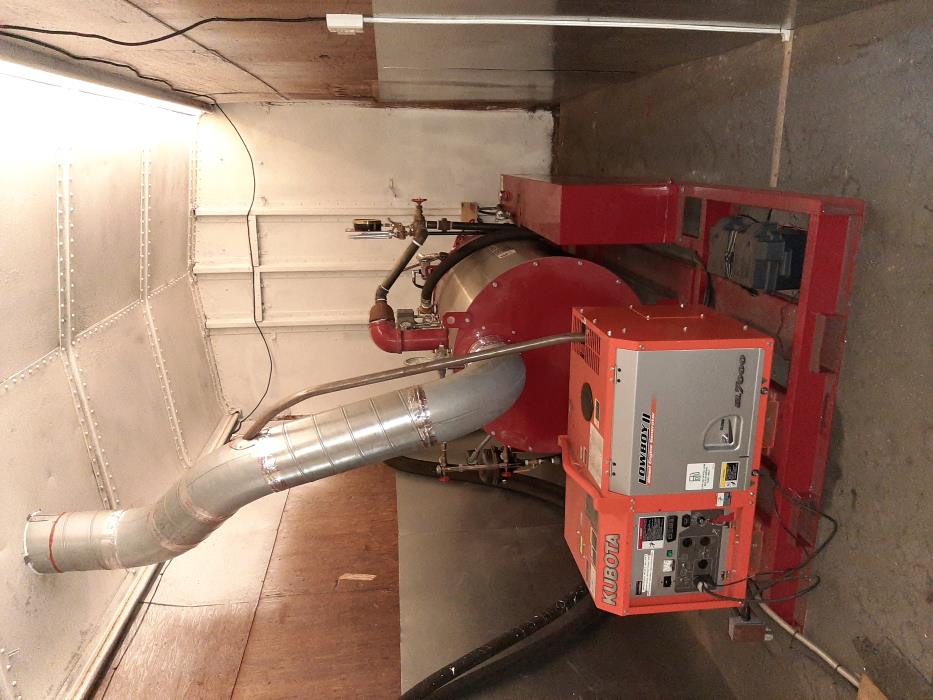

Wilmington & Western converted a boxcar to a heater car using a commercial skid mounted steam generator from Sioux Corporation.
https://sioux.com/steam-generators
- Alan Maples
