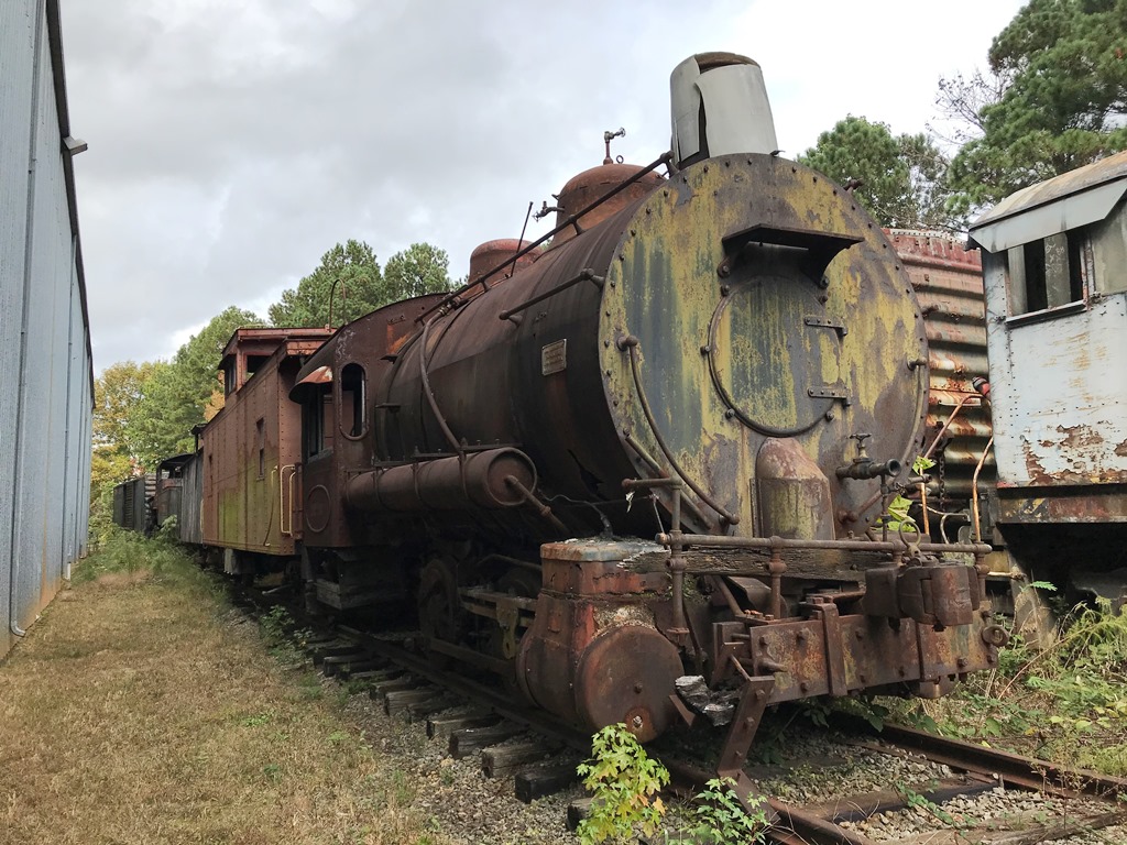

The Southeastern Railway Museum in Duluth, GA has available Lima fireless 0-4-0 "Dayton" which was built for National Cash Register in 1913. The Museum's Board of Trustees recommended deaccessioning to the Atlanta Chapter of the National Railway Historical Society as part of the Museum's ongoing effort to better define its collection focus and policies. The Atlanta NRHS Board ratified the action a few years ago and we are now ready to accept qualified offers.
Please contact the Museum at steam@train-museum.com for details.

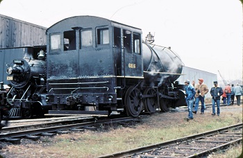

Hi
The last time I saw a fireless cooker under steam was at the old Steamtown in Vermont during the 1980 railfan's weekend,,..
Steamtown had 6816 in Steam during the weekend,, one of the CPR pacific's was supplying Steam for the cooker..
Here's my photo of the locomotive by one of the sheds,, also you can see CPR 1098 in the photo.. Pat.
File comment: Photo by Pat Fahey
Fireless cooker # 6816 Steamtown Oct 1980 Photo by Pat  Fahey  #  3.jpg  # 2.jpg
Fireless cooker # 6816 Steamtown Oct 1980 Photo by Pat Fahey # 3.jpg # 2.jpg [ 41.8 KiB | Viewed 6530 times ]
