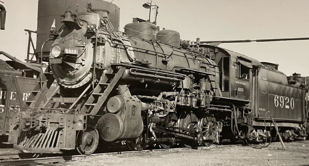

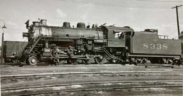

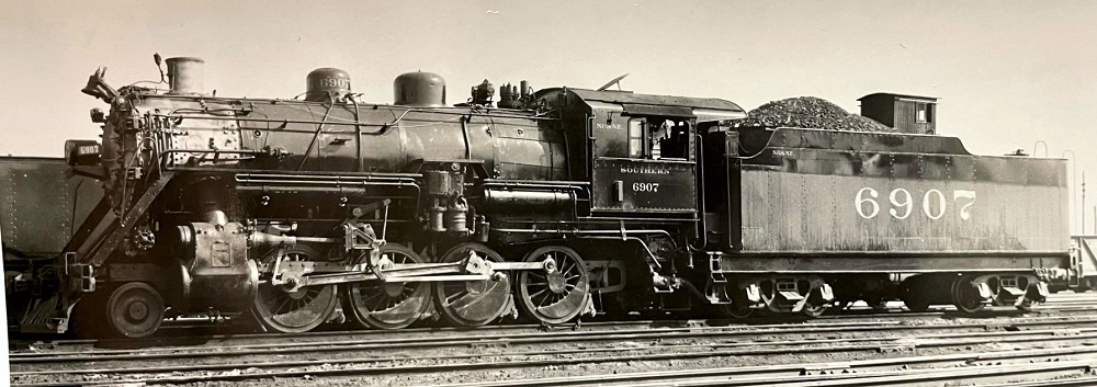

8338 and 6920 have Elesco FWH systems, with the more modern coil style heat exchanger located ahead of the stack.
6907 has a Worthington S-type system, with the hot water pump on the pilot and cold water pump under the cab.

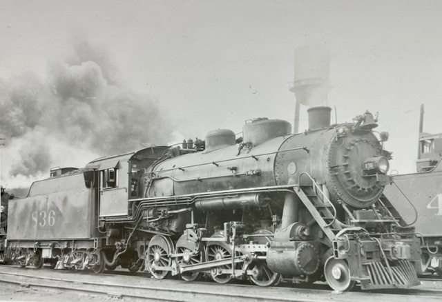

Most of the Southern engines which were retrofitted later in life, be they Ks, Ms, or Ts, got the Worthington S-type. They usually got a big non-lifting injector on the engineer side at the same time. The 836, and Atlanta engine, had the Worthington heater fully recessed in the smokebox with only the water pumps and heater exhaust to indicate its presence.

You are spot on. SR Ks Class 836 very clearly does have a Worthington S-series system on it, as can be seen by the hot water pump on the pilot deck.

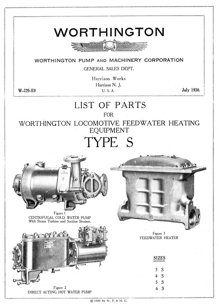

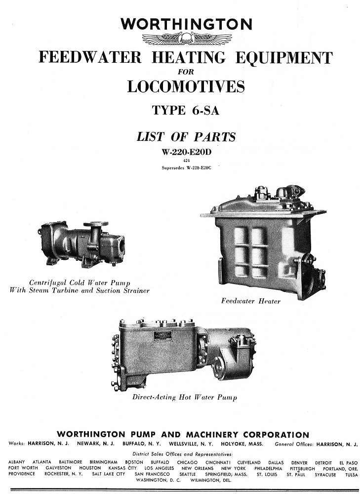

As best I can tell from a Worthington advertisement, what distinguishes the S from the SA system is the location of the piping into the feedwater heater itself. The SA has either a cast or pressed steel top with a cold water inlet built into the top. The type S feedwater heater seems to have a more rounded top without these connections.

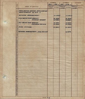

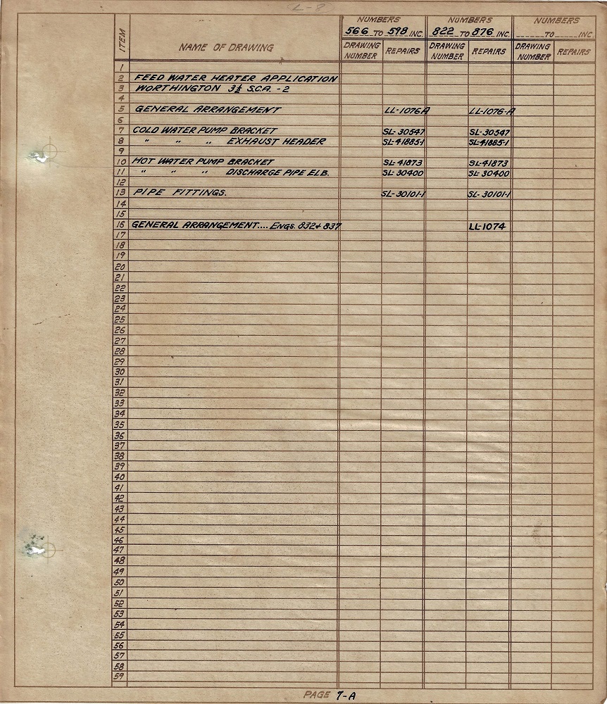

A curious bit of data which we found in Southern's mechanical department lists of drawings for the K, Ks and Ks-1 locomotives (L-7, L-8 and L-9) was a specification for the Worthington 3.5 SCA-2 system. None of these drawings in Southern's list are known to exist, neither with the SRHA or in the Bill Purdie collection at SERM, and I have not seen any illustrations of the SCA-2 system. That's why I was hoping to get a copy of the Worthington maintenance manual on these systems.
I'll attach a few examples of the documents named above.

Thank you for pointing out the Elesco coil type feedwater heater on both GS&F Ks 8338 and NO&NE Ks-1 6920. I suppose that big oval box ahead of the stack is the give-away, along with the typical Elesco pump mounted beneath the running boards. That pump appears to be visually about the same as those used with the Elesco bundle type feedwater heaters.

It is interesting see how far recessed the unit is on the 836. I guess this full recessing would make smokebox cleanout/maintenance more difficult since more of the unit is inside it vs the more normal look with the FWH box in partially sticking up in front of the stack.
