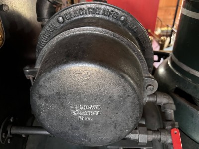

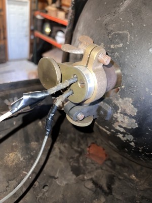

Good evening,
I am doing some maintenance work on a 1925 Baldwin steam locomotive, and as part of winter maintenance am completing a complete rewiring of the electrical system. The previous wiring job I am finding is both incomplete and questionable, and I am having trouble finding light bulbs, resistors, and information on the electrical system.
The locomotive is equipped with a Sunbeam Turbogenerator, as well as two Sunbeam Headlights. I am unsure of the model, as the tag is missing, but I believe it is a 32v 500w turbogenerator.
The light bulb currently in the headlight is a 34v 250w bulb labeled "Made in EC". The locomotive is missing the resistor and fuse box, as the wiring was only partially completed, so currently will only operate on high. The switch is a Ralco three position switch, with a bottom twist switch for the cab light.
I am looking for any sources and guidance on the following:
- Headlight bulbs
- Number board/headlight compartment bulbs
- Cab bulbs
- Resistors
- Fuses
- Wire sizes
- Period accurate wiring and hardware
- Electrical wiring diagrams
Any of the above would be appreciated. If anyone has pictures or diagrams of how their engines are setup that would be appreciated as well.
Thank you in advance,
Matt
File comment: Ralco Switch

File comment: Sunbeam Turbogenerator Fireman Side
File comment: Sunbeam Turbogenerator Engineer Side
