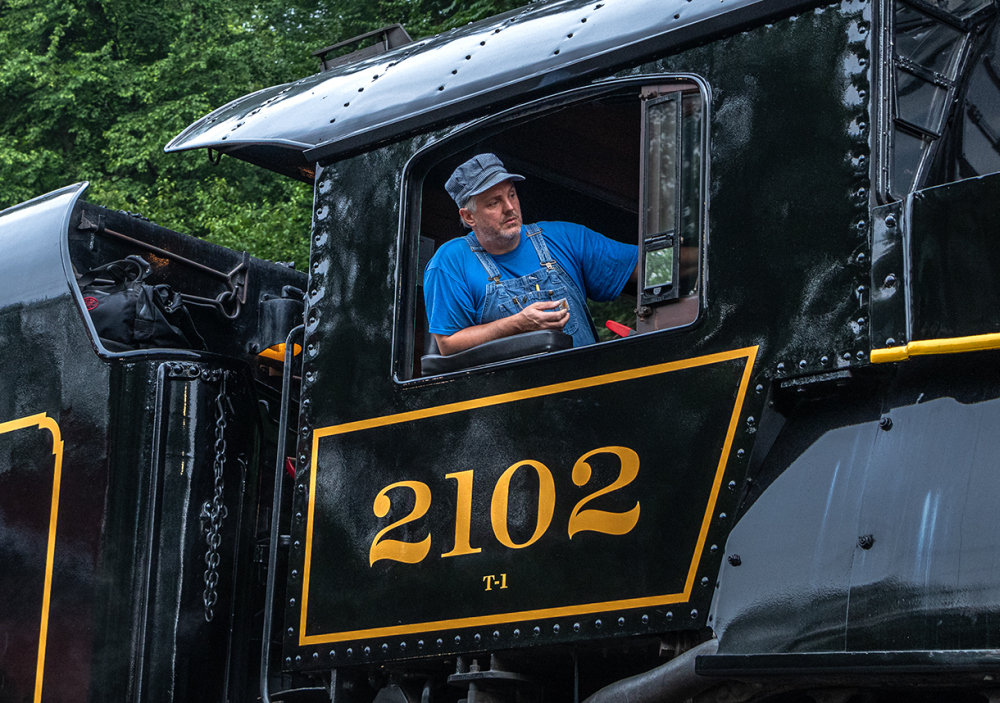

...and the Reading yellow, Hostler, is the same color as Lackawanna Yellow which I'm thinking you might be familiar with. Mr. Mueller is currently using an Imitation Gold-like yellow ochre on #2102. You can tell it's just a little too dark to be Reading Yellow but hey, a gallon or two of New Caterpillar Yellow isn't hard to find right off the shelf... ;)

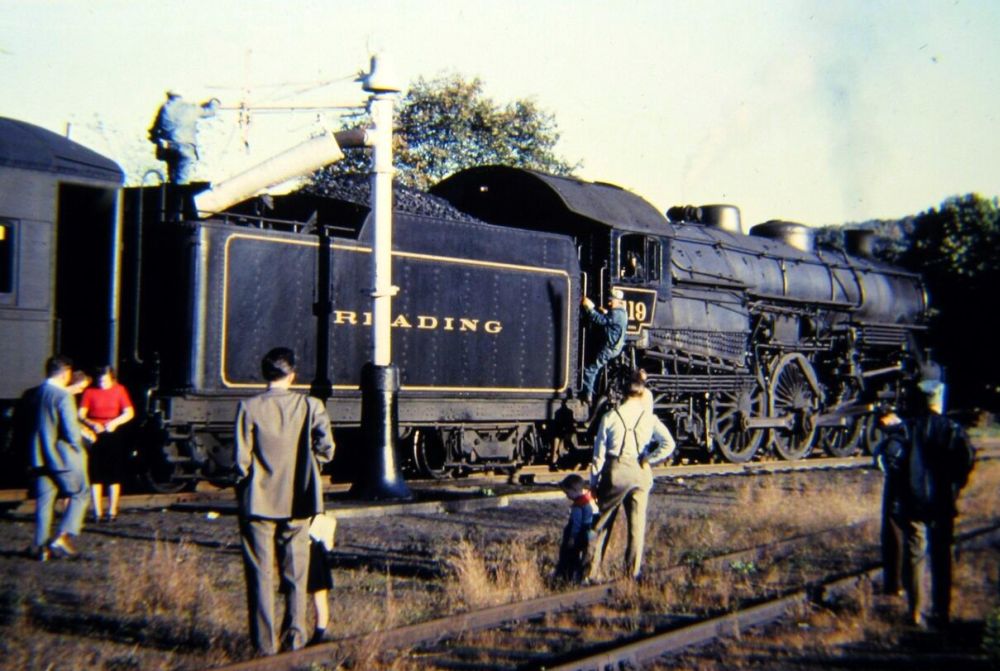

No longer clad in shining armor because it never was, here's #119 up in Pine Grove with its black arched window frames...

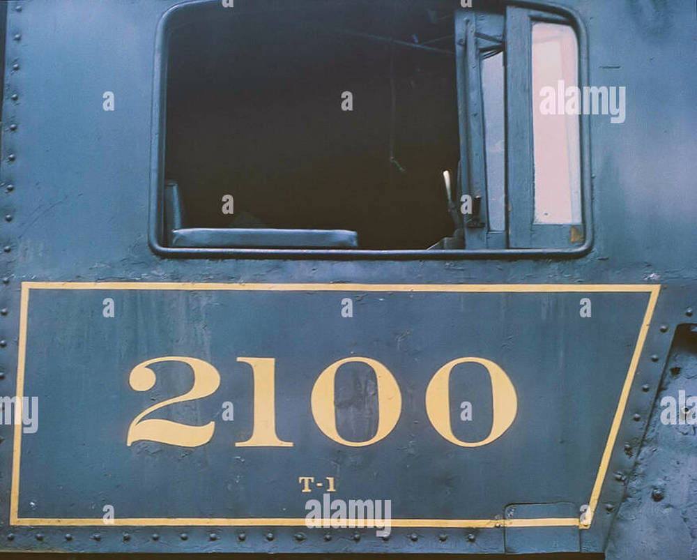

As far as the window frames go, I don't think there's any doubt they should be black as in this shot from September of 1964...

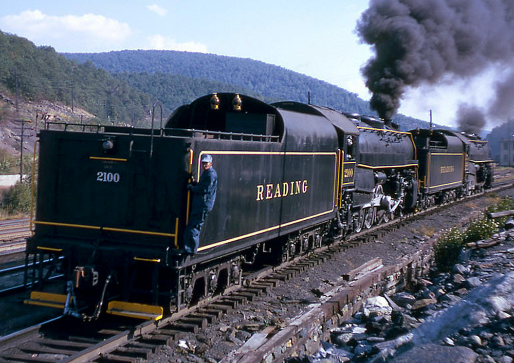

Now this is a view you don't see too often. Apparently, with the special ramble scheme, the locomotive number on the rear of the tender was painted in Aluminum as well as the train steam connection down by the coupler...

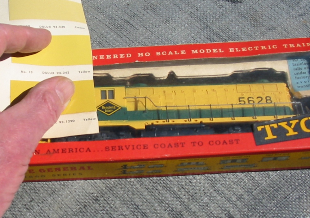

Currently at Strasburg, #1251 is wearing New Cat Yellow as a lettering and striping color, Phil, while on the cab training models, as painted by the Reading, it's Venetian Yellow, perhaps appearing slightly darker on the T-1 and FP-7 representatives since, as O484 mentioned in his posting, it is applied over the black.
The yellow on the original early-sixties Tyco Reading GP-20 is also a close match to DuPont 1290 so it's pretty much the same color on the GP-30's, 35's, etc., only lots more of it. The model does look slightly more orange than I think it should but it is molded in a somewhat translucent plastic, not paint. The next time I head down there, I'm taking that thing with me just to see because I forgot to do it the last time around...

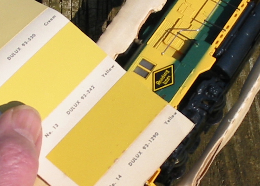

What the heck, why not? LOL
That's the standard Reading Yellow on the caboose body and safety yellow on the handrails and brake wheel. On the SW-1001 in its "green machine" colors, it's all safety yellow and along with black on the pilot.
The colors on that Tyco model might be fairly accurate, huh?...

Figured I'd try that again this morning in an attempt to cut down on the amount of red emanating from the body shell. Looks like I've achieved a moderate level of success this time around so that's always good...
