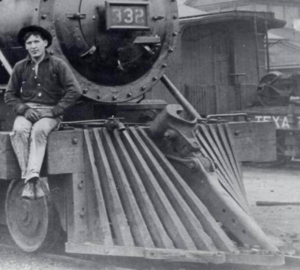

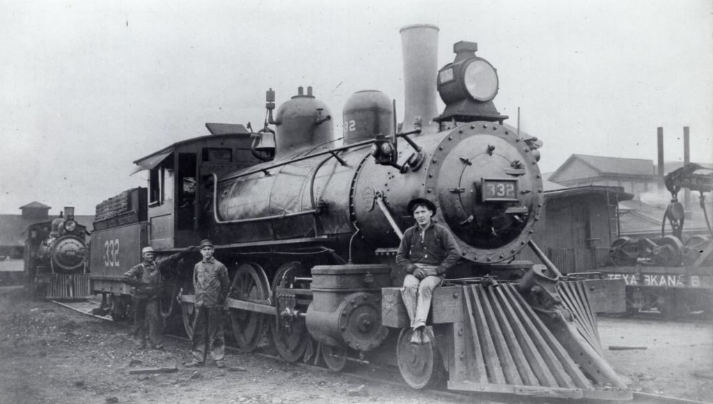

In this photo we see Kansas City Southern 4-6-0 No. 332 posed with its crew in Shreveport, Louisiana in 1905.
No. 332 is sporting something on its pilot that I had never seen before, a combination link & pin / automatic coupler. From what I can tell, the link & pin drawbar is always there and ready and the automatic coupler can be flipped down and up as needed. It is also interesting to note that the automatic coupler has a fixed knuckle and that there are no pin lifters / cut levers on the locomotive.
Interesting to see that link & pin couplers stayed around for a while.
EDIT - I'm FIRED! Looking at the photo closer, it is apparent that it is just a fold down coupler whose mounting casting, for some reason, extends down and out to the front of the pilot. Still interesting in that it has a fixed knuckle.

Back in the day when they were really serious about the whole "cow catcher" thing, my guess is they were concerned that the cow would be gored by the coupler and held fast on the pilot. If the coupler was rarely used, then folding it away made sense.
In reality, engines double-headed quite often, and folding the coupler away was more trouble than it was worth. Note also there is no air brake hose. They were that confident that coupling in the front was not going to happen.

Though quite fuzzy, the engine behind the prime subject looks to have the coupler folded down and an air hose hanging in place.............PD

The #332 looks to have an angle cock on the engineer's side, this was often done so the engineer could see his helper go in between to cut in the air...
Thanks for posting this, in all my years of model railroading, I've never before seen a "prototype" dummy coupler.
