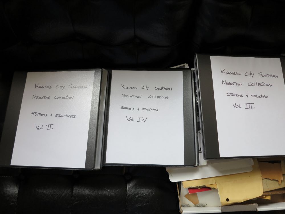

As to what I am going to do with them, I am not sure yet, I figured step one was get them into a better storage format and in the process organize them and figure out what is there. To that end, I have been placing the negatives in 4x6 photo pages and thence into binders, organized by subject. Once that is done, it will be time to decide what comes next.

File comment: Notebooks anyone?

I should add DO NOT put the negatives in plastic sleeves. Put them in individual acid free paper envelopes. Plastic sleeves will speed up the degradation of the negatives.

Hopefully, a short stay in the photo pages will not be detrimental to the negatives. My goal was to put them in some format where it was easy to see what they were and then work on scanning them. As I am able to scan them, I will make prints and place them in the photo pages and then put the negatives in appropriate envelopes.
