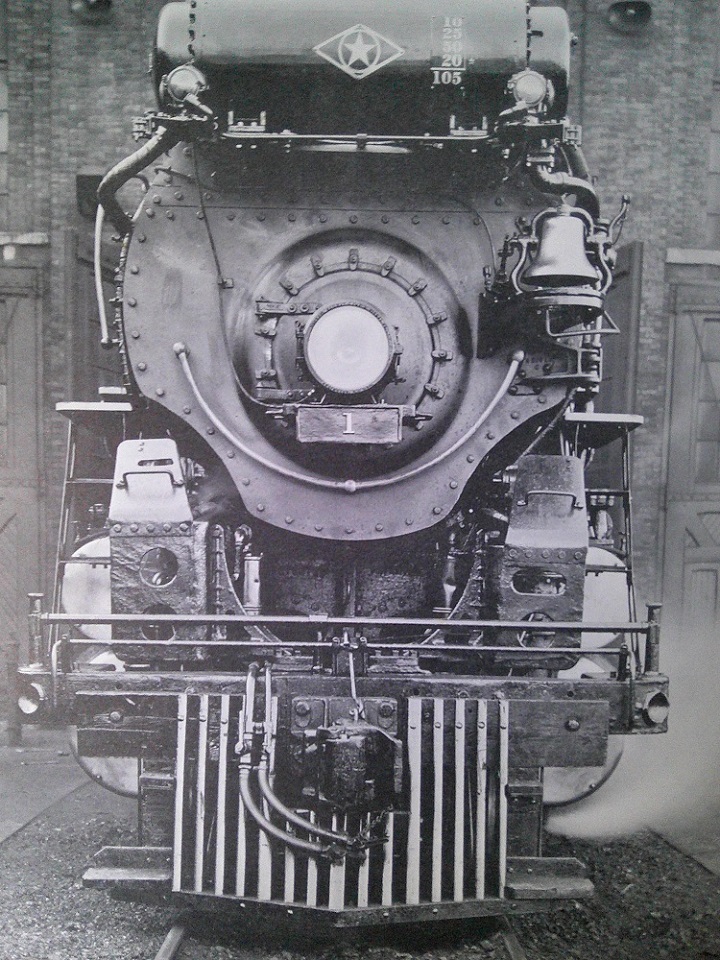

One of the members at our museum asked a question for which I did not have an answer. When 2-8-4 # A-1 rolled out of the Lima Shop back in December of 1924, on the cylindrical Elesco feedwater heater up on the "brow" of the engine's smokebox, it had a star enclosed in a diamond in the center of the Elesco and on the right side a "plaque" which listed the following numbers:
10
25
50
20
___
105
I have not been able to figure out what these numbers signified and can't find any printed references to them. Anyone know? Thanks!

Is the plaque shown in the linked photo? I can only make out casting numbers on the header casing but nothing on the plaque. Initially, I thought it might indicate the number of tubes in each quadrant, but it doesn't make sense to have unequal numbers, and I don't see how they could fit 50 in one quadrant. By 1929, a heater for a large locomotive (#7 heater?) could have 156 5/8" tubes (39 / quad). I'm certain that has nothing to do with the info on the plaque. I suspect the plaque in the photo has company and patent data and there doesn't appear to be a diamond-star plaque on the front, although it could be obscured. Could the numbers in question have something to do with the theoretical volume of condensate to be collected from engine and auxiliary exhaust and returned to the tender?

I don't see your linked photo. The shot I have seen is of the 2-8-4 rolling out of the Shop doors at Lima and was taken from the front end. I can't post that shot here on RyPN because it is too large and I can't figure out how to reduce it.
I have seen a photo of the A-1 demonstrating on the C&NW in 1926 with the "star in diamond" metal plaque still in place on the Elesco heater but the plaque in question, no longer on the loco at that particular time.

It was my understanding that the 'star in diamond' was kind of like the badge for 'Lima SuperPower -- the diamond referencing the Lima builder's plate.
Did anyone look at the drawings in that kid's book on the A-1 Berk to see if the numbers in question on the end of the heater vessel were shown? My speculation is that these represent some measure of heating surface in stages of the FWH (not percent, as they are all in coarse multiples of 5 and don't add to 100"%" -- someone might look at a diagram of the internal construction of the heater and see if the numbers match surface or heat gain for 'passes' within the device. (See p.356 in the '47 Cyc directly above the coil-heater drawing I mentioned in the thread on Southern Ry. locomotives.)

Okay Adam, I've now seen your linked photo. Although it shows the A-1 in the final steps to completion, the "star in diamond" and the "metal number plaque" have not yet been added to the Elesco. Perhaps these numbers on the metal plaque (as has been suggested) pertain to the heating surface of the feedwater heater, and not to the locomotive itself. Perhaps that is true. If so, what does each number pertain to? If not, we still haven't solved the mystery.

Les Beckman wrote:
Adam -
I was finally able to get a smaller shot of Lima 2-8-4 #A1 and am including it here. Still would like to know what the four numbers signify, that sit there on the Elesco feedwater heater.

Well there are 4 tube chambers within the FWH so I would think that the 4 numbers represent something for each of the 4 chambers. Tubing length maybe, but that seems like an awful lot of variation between the 4 (although I know they weren't identical).

What is SO frustrating about those four numbers is that they add up to 105, which is shown under the four numbers! LIMA, why did you do this to us inquiring minds, here in the 21st century?
