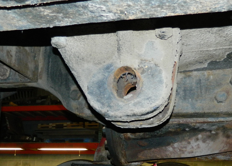

I could use some advice from someone with experience welding old (1920-1925) cast or forged steel. These parts spark test like steel and are physically malleable. I don't believe it is malleable cast iron based on the spark test. They take hardened steel bushings that have loosened and spun requiring the holes to be filled somewhat and re bored. The faces are worn and need some build up. They have been welded on the faces at least once probably 70+ years ago. Both the old weld and the base metal "fizz" when melted with a TIG torch. Preheating to 400+ does not change the results. TIG - 100% argon with ER70S-6 ends up porous. Stainless 309L works but I suspect it will be harder to machine. These parts were obviously welded before. We could TIG braze them with silicon bronze but I was hoping for more wear resistance and I'm guessing the bushings would be retained better in a steel bore. For a sense of scale the ring shaped end has 2" OD. One picture shows old weld buildup. The other shows partially ground back ER70S-6 bead that has porosity. The video shows how the base metal with no filler bubbles and becomes porous when melted with TIG torch.

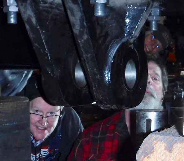

Can you bore the hole just enough to clean it up but dialed in on the current hole, then make an oversized bushing with a new hole off center in the bushing but located in the correct place to give the proper spacing on the finished part? That's what we had to do on the fulcrum for the equalizer for the lead truck. If you look closely at the photo of the rebuilt part you can see the edge of the bushing and that the hole is well below center. I think some spring hangers got the same treatment.
I was thinking this might be less intrusive and the amount of work vs using off the shelf bushings might balance out. We don't have a very good setup for heat treating them. I still need to find a way to resolve the wear on the faces. Someone welded these in the past.

We did another spark test and compared it to some modern steel from a piece of angle iron - possibly A-36. They look similar to the base metal on the parts. Also there is some rust pitting but nowhere does it look like wrought iron's "wood" grain. I don't think it could be malleable cast iron either based on spark test.
Several of the parts have oversized and oblong holes that don't seem candidates for boring to fit an oversize bushing.

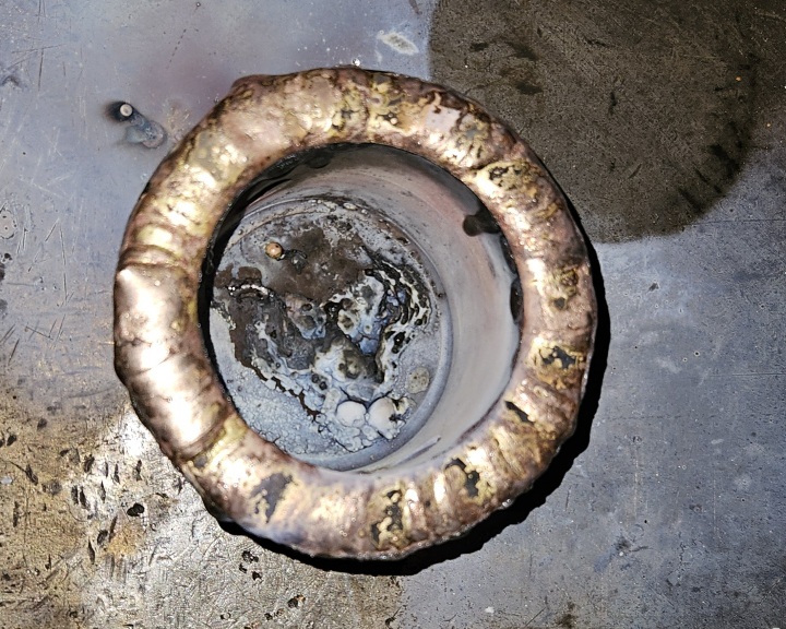

It is really hard to say not knowing what the original filler was. I have found with contaminated aluminum castings the first pass is usually dirty. Grinding it off and the next will be good.
This is an axle thrust collar I did with a torch. It will be machined and wear against a cast wheel hub.

Joined: Fri Apr 03, 2020 4:39 pm
Posts: 10
CJKlossner wrote:
Yes bronze on bronze does not make for a good wearing surface. Cast iron is really the only reliable metal to wear on itself. We are doing some gears in a similar manner. The small gear is getting 309 stainless and the large gear silicon bronze. The only difference being it is applied with mig.
Thanks, I'm going to take a closer look at how parts interact with others tomorrow. Nice job on the brazing. Our mig machine is a toy (145amp) so I went with tig. I put down 10+ lbs on some blacksmithed truss anchors that had rusted badly where they interfaced with a wood sill beam. That was my first TIG brazing and I was surprised how nice it worked.
I'm tempted to try to TIG 309 the faces and TIG Si Bronze the bore buildup. I find it a bit more difficult to shield the bore work with the required tungsten stick-out. I think the bronze would go better. You should have a private message with my phone number should you be willing to take a call tomorrow. Many thanks, Ernie
