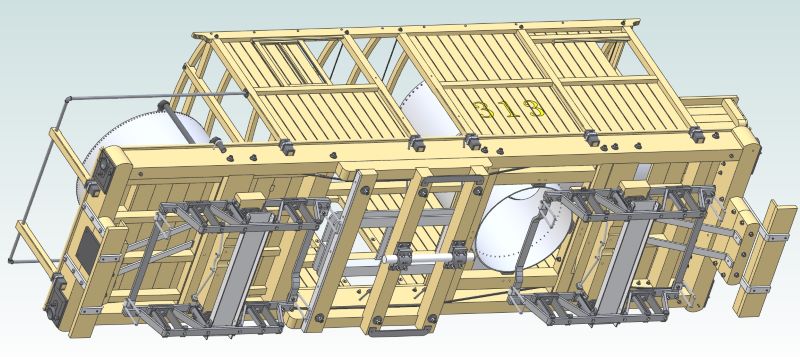

CORRY R.A.I.L.S. has begun the process of restoring/renovating CLIMAX A-313. The below is an image of a partially assembled 1902 Class A Climax A-313. All dimensions were taken from the WOOD and have not been confirmed by attaching any steel or iron parts or measuring any such parts. Therefore this is a first approximation subject to remeasuring and remeasuring and assembling some parts to determine the (hopefully) original sizes of the wood parts 120 years later.
The cylinder shown is to indicate to the viewer the location of the Boiler and is NOT based upon any measurements of the Boiler. I will be preparing 2D drawings of each part so that the measurements can be confirmed and corrected and a 3D CADD Model be created from which to re-create the parts.
Link to 3D pdf. Best viewed in Solid Outline in Adobe Acrobat Reader.
https://s3.amazonaws.com/SIMONTON/A-313+Frame.pdf

Having been there at the open house in May, looking at the rather large wood puzzle of the disassembled wood frame was actually encouraging.
The entire sills are southern yellow pine, not oak, reportedly as oak would be too heavy. There's a variety of wood on it. That sketch doesn't do justice to the rather intricate jointwork of notching and dovetailing though that Climax did in that era.
One sill side is relatively intact, and the other is very deteriorated, but as the only surviving one of it's type, even having shards to measure is a huge advantage.
The other nice thing is that Corry, PA is on the southern edge of a large, and growing, regional Amish population. There were lot of Amish at the open house. As this isn't exactly prime farmland up here in NW Pennsylvania, the local population is primarily skilled trades - including home sawmills, all manner of steel and leather crafts, etc. If you have original wood pieces and can scale it out, to them it looks like just another barn, this time on wheels.
I have an Amish friend up there that's both a railfan and an HO model railroader, he has an exquisite finish-grade sawmill of furniture quality, all powered with a natural-gas engine and electric generator from his own well (legal) and an overhead-belt driven mill powering nearly everything that would make the EBT machine shop fans feel right at home. So for a Climax, with a lot of wood, the local resources are actually there.
The other thing about A313 that surprised me was that while it's 36" gauge, the wheels look like they were done by Lionel - wide tread and deep flange. It looks like wood beam or strap rail wheels. Supposedly they were ordered that way to compensate for the 'irregular' nature of the gauge in Alaska due to permafrost heaves.

Check out the 3D pdf. One can hide parts in a 3D pdf to observe the Mortises and Tenons which are concealed.
Note the Mortises in the Front Bolster. I speculate that A-313 was a transitional frame from Vertical Boiler to T-Boiler with the Cross Member behind the Front Sill being added to what was in essence a Vertical Boiler frame design to support the Smokebox Saddle of the T-Boiler making the mortises in the front sill redundant.
Just a thought as the thought process is just beginning.

It's a fascinating locomotive not just because it survived at all when so much of it is wood, but it's a living piece of engineering history in the evolution of geared steam.
I'd have to spend some more time in the Climax book and studying build numbers and photos, but the boiler on 313 that's clearly a transitional vertical to horizontal design is fascinating to examine. Obviously it worked or it wouldn't have survived, but so has a Platypus.
I've always admired Scott's (Gilbert) patent design for the helical drive gears, but there's lots of other little brilliant touches on a design both this old, and this basic, to admire, and to make it 'simple stupid' to maintain with few resources at hand.
