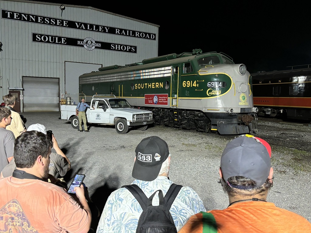

Last week at TVRM during the NMRA night photo session...

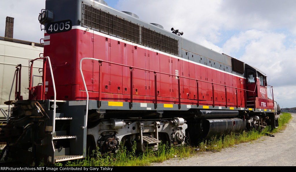

Steamguy73 wrote:
(i still have no idea what happened to MKT 200).
This is the latest photo I could find of it, as FTRX 4005 in 2018. It obviously was owned by Railtex at one time, and still has its paint. https://www.rrpicturearchives.net/locom ... -200/23013

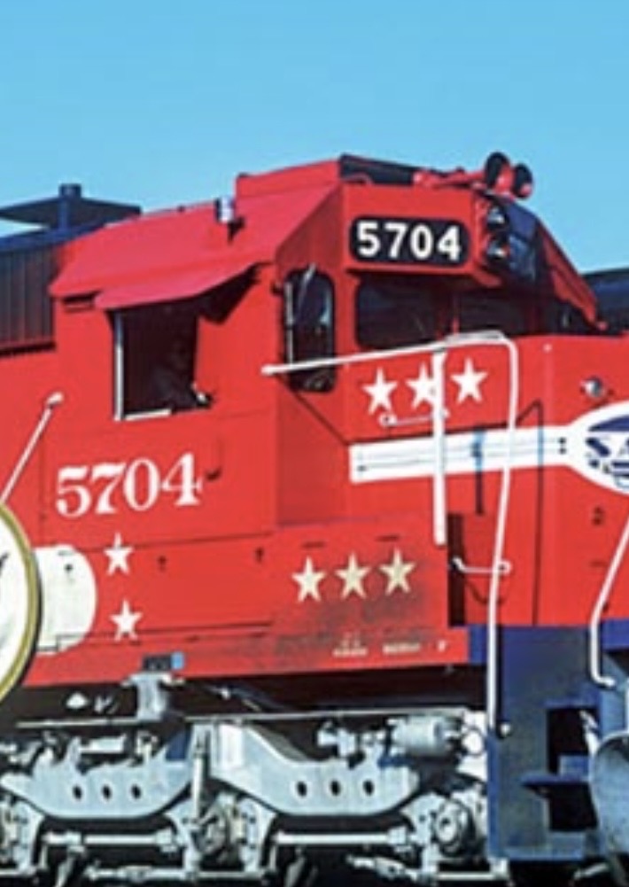

SF5704 is fully repainted back to its 1976 paint scheme and is operational again. We use it at the SCRM museum to pull our excursion trains. At the moment BNSF has borrowed it to show at the special get-together of bicentennial locomotives in Spencer North Carolina the end of this month.
