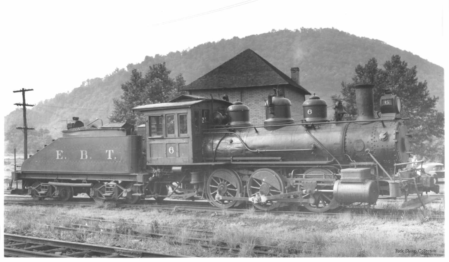

 Post subject: Re: Found lead ore engine *PIC*
PostPosted: Wed Dec 31, 2003 10:42 am
> Sorry to be so unknowledgable on this
> subject, but in short could you explain the
> meaning of gauge and 4-4-0 Brian
Gauge is the distance between the inside faces of the head of the rail. Most modern railroads in the US and Europe use "standard gauge" of 4'8.5", so called because it is the gauge most railraods standardized on. Smaller gauges were called "Narrow Guage" and larger one "Wide Gauge". 36" was by far the most common narrow gauge, with 24" and 30" also popular. An industrial railroad could be about any gauge, but was usually narrow. Establishing the gauge of the locomotive helps narrow down its origins and identity, though it does not identify a make.
Designations such as 4-4-0 or 4-6-4 or such, indicate the wheel arrangement. The first number indicates the number of "Pilot Wheels". Pilot wheels are small wheels near the front of the locomotive that help guide it into curves. The second number indicates the number of "Drivers". Drivers are the larger wheels that actually propel the locmotive. They have the rods attached to their sides to link them to each other and to the steam cylinders. The third nubmer is the "Trailing Wheels" which help support the firebox (back part of the boiler where the fire is) and the cab (where the operator is.)
The boiler is divided into three sections. At the rear is the Firebox which is recognized by its squred off bottom. This is where coal, wood or oil is burned to create the heat for the locomotvie. In the middle is the barrel, which is a cylinder full of water. It has flues or tubes passing thorugh that carry the hot gasses from the firebox to the smokebox to heat the water. At the front is the smokebox. It is a hollow section that looks like the barrel but has no insulation on it. The steam cylinders are connected to the smokebox by large pipes or castings that eject their steam up the stack, which comes out of the top of the smokebox.
Most locomotvies have a builders plate which is the most revealing piece of information. It contains the builder name, date and serial number. The builders plate is generally located on the left side of the smokebox. Some also have one on the right side. It may be round, rectangular or diamond shaped.
In the example below, this is an 0-6-0. Note the round builders plate on the side under the stack. The smokebox stats where you see rivets rather than a smooth skin if sheet metal and insulation covering the rivited steel. The firebox is obscured by the cab and the rear driver.
Hope that helps.
