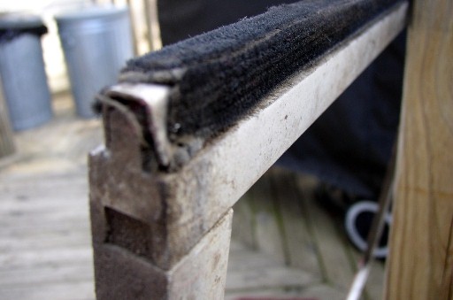

Stuff was called schlegel strip (or something like that) Problem is that the old automobile version has the bristles inside the U, and if the windows are Adlakes, the bristles are outside of the U. I ended up cleaning all of the old stuff out, and importing a courdoroy material used for the same function in Jaguar restoration in the UK
File comment: Bad old stuff

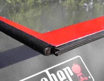

File comment: Good new stuff
Would have to do some digging, as it was nine years ago. We bought enough that it did a second caboose in Owosso after mine.
Warning: this stuff is essential. If you do not have it the windows rattle enough that the latches may let go and the window becomes a guillotine.
