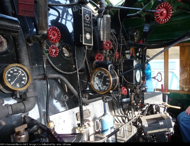

Santa Fe 3751 has one as well.

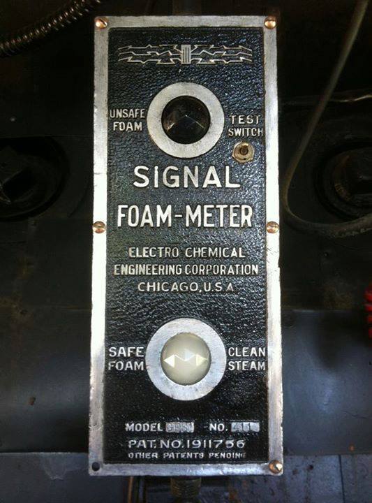

Posts: 329
From Altoona Works Facebook page......
https://www.facebook.com/photo.php?fbid ... =1&theater

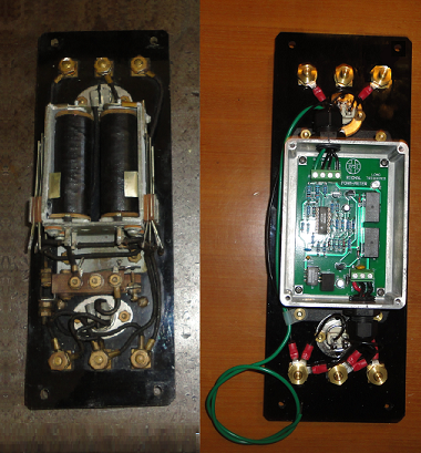

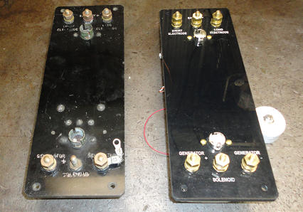

I don't have access to an instruction plate. Good luck in tracking it down. Here's more information on the Santa Fe 3751's Signal Foam-Meter that may be of interest.
In addition to the foam meter, the locomotive is equipped with a foam separator atop the boiler ahead of the cab. However, the solenoid and electromatic blowoff valve that release foam into the separator have not been used in excursion service. The original equipment usually included a trough in the boiler headspace that collected the foam, but this feature was not included in the 3751's restoration. The manufacturer's literature indicates that the automatic release equipment was optional.
In April 2014 a new electronic version of the foam-meter was installed and successfully tested on the 3751. On one occasion, the white "Safe Foam" lamp triggered when ascending a flyover with water high in the glass. The system was probably triggering by high water rather than foam. This lamp has a 29-second delay.
