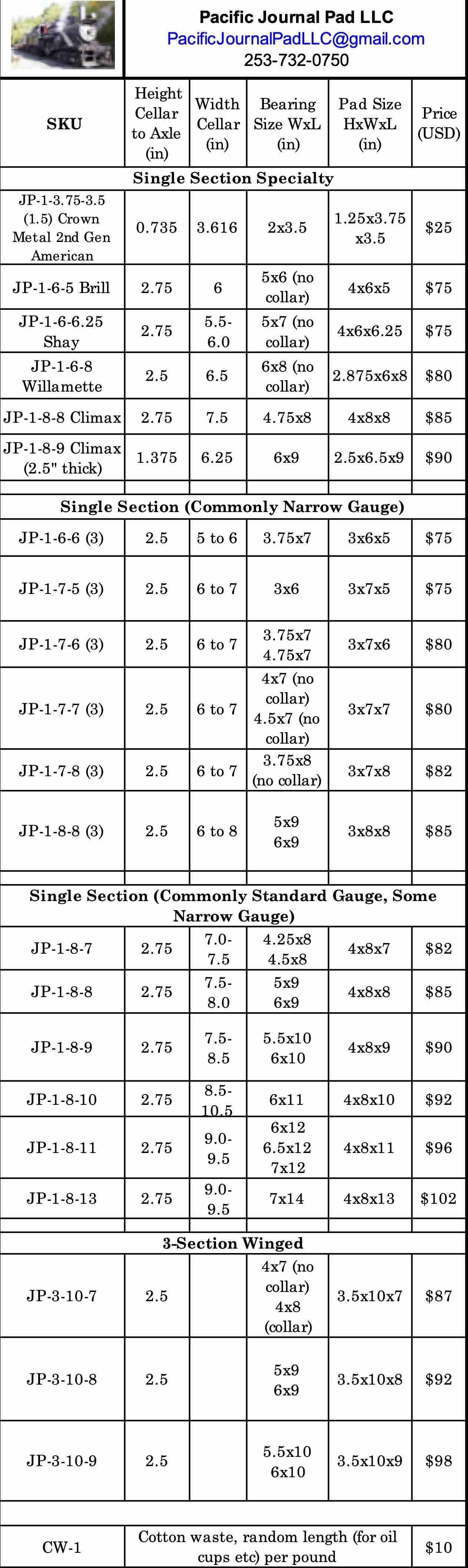

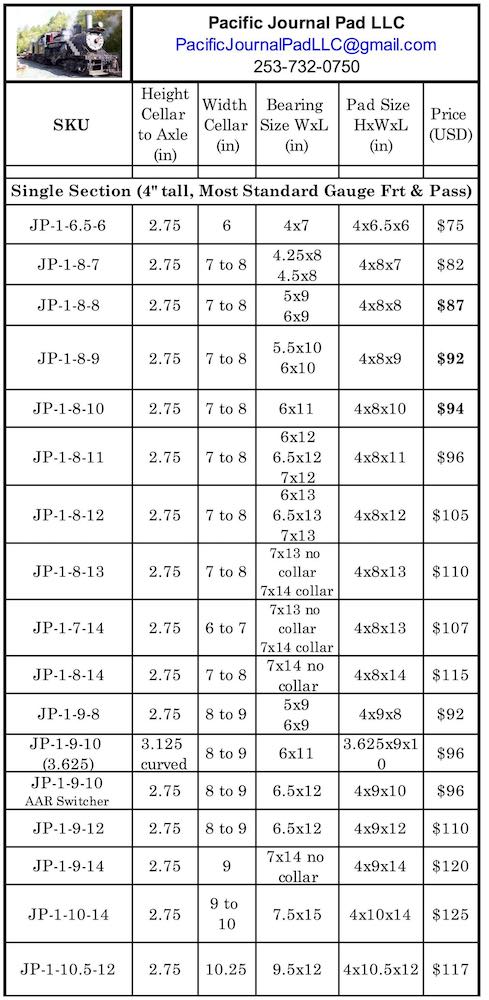

We want to build a database of pad sizes relative to axle bearing size so we rely on customers to bring their needs. Attached is our current 2021 price list for single section pads, with a few gaps where we need customer data on pad dimensions for those bearing sizes. We are happy to make any size or shape you need including winged pads.

Thank you for all the interest in our journal pads. We continue to expand our lineup based on customer needs so you can expect the list to grow as we hear from people with other projects. The current price list shows what we have specified so far.
As always, we are happy to make custom sizes, and we simply adjust cost for according to the materials. There is no additional setup fee for special sizes because we hand-make everything.

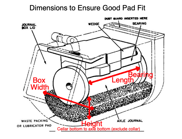

We've been busy making journal lubricating pads for dozens of railroads. Some orders included pads for geared steam locomotives, narrow gauge locomotive driving boxes, and several sizes of winged pads. We have learned that we need some key information to fit a pad correctly.
1. Vertical clearance between axle bottom and journal box bottom. Don't include the collar on the end, we just need clearance in the area that runs around on the bearing. This is usually about 2.75" for standard gauge rolling stock and 2.5" for narrow gauge, but it's best to check because it's important to have the correct thickness to avoid excess pressure or too little contact.
2. Bearing brass length along the axis of the axle. Actual lengths usually end in 3/4 and are rounded up to the nearest inch. For example 8 3/4" brass is known as a 9"
3. Journal box bottom width side to side as you look in through the door. This varies quite a bit and for smaller axles it's important to get a snug fit so the pad doesn't have excessie movement when the axle changes direction.

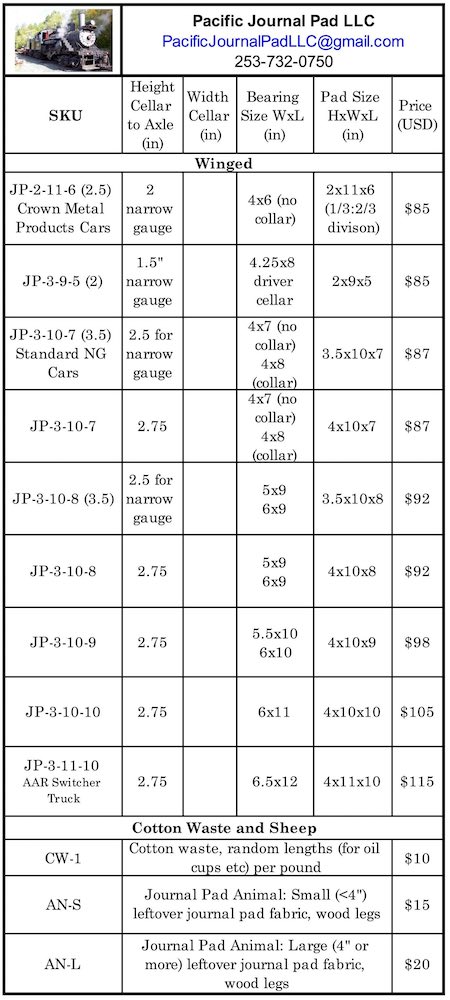

Shown below is a basic price list for simplicity, but the whole catalog became too long due to all the custom and one-off sizes. Since I make them all to order anyway, it's best to just contact me and let me know what you need. That way we can ensure it fits correctly since there are so many different box designs. Just send an email to PacificJournalPadLLC@gmail.com and we can chat via email or phone from there.
With the addition of our new machine, we became more efficient at making pads, so I chose to absorb the recent materials cost increases and keep prices steady. In addition, this reduces turnaround time so I can get orders out much more quickly, usually in under a week. Although we are about the only company that makes these pads, I want them to remain affordable, because staying on budget is important.
