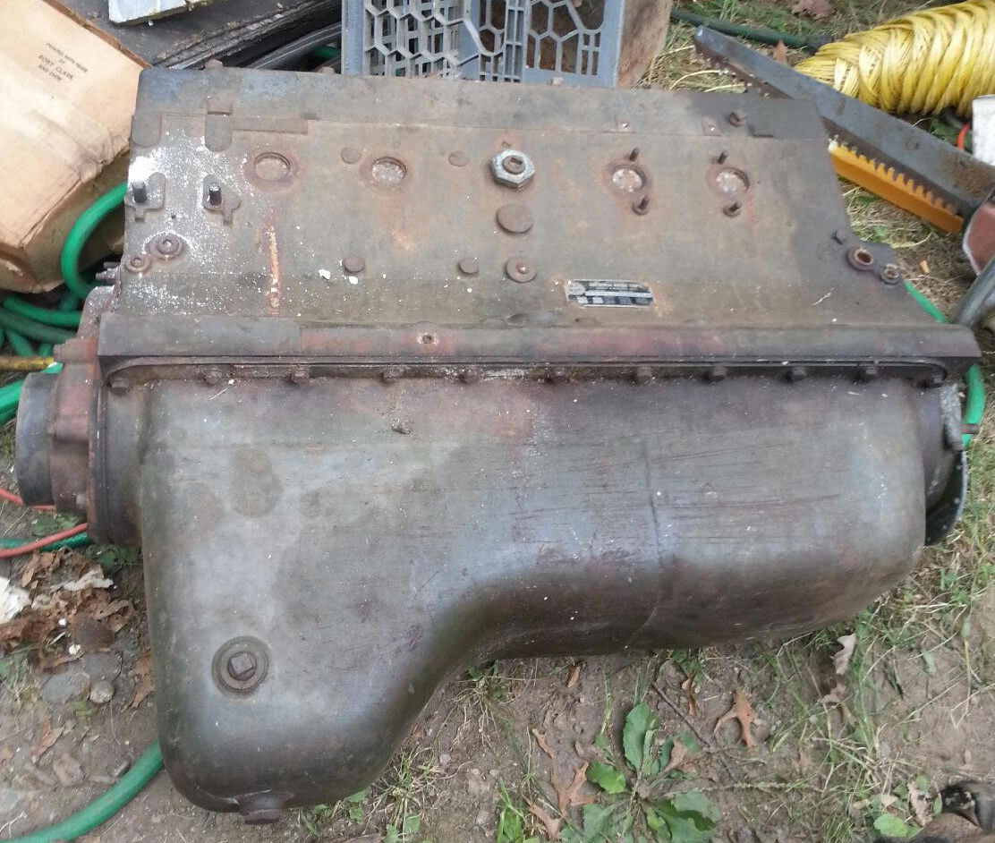

At this point the crate is long gone. However, if it pleases the court, I'd like to introduce exhibit A;

By chance, it doesn't have "RED SEAL" cast into the side of the block. Looks about like the standard industrial 6 that was used in many forklifts and other equipment. I want to say they were in the F series of engines.
 Post subject: Re: Riddle me this; Continental Straight 6
PostPosted: Wed Aug 12, 2015 1:23 pm
Posts: 367
A little bit of cross searching shows that it is most likely a 4 1/4 bore, 4 7/8 stroke flathead six sold to Clark Equipment Co.
