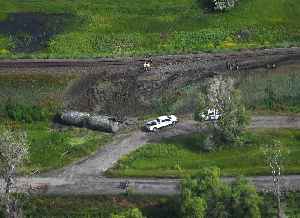

Actually, something they will be trying to figure out is if the bridge collapsed causing the train to derail, or the opposite, but I doubt that the person who wrote the original understands that distinction. I generally would bet on the latter, a derailment first taking out the bridge, given that these were tank cars loaded with molten sulfur and asphalt, but we'll find out how old that truss bridge is soon enough.

This photo, added to the original article later, would seem to show a car derailed on land, but it is not clear if it is on the east or west side (the train was westbound):
