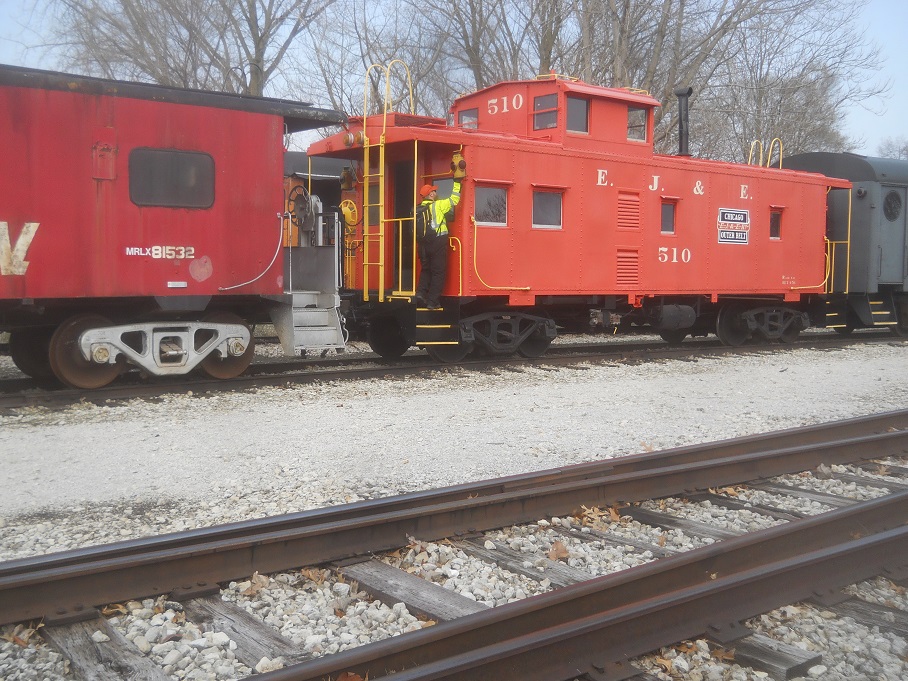

toot - We have a set of PRR caboose markers that we use at our museum. Of course, these are still kerosene powered and not converted to battery power. Here is a photo of Conductor Mike C. as he starts to take down the markers after the last run of the day on March 30, 2024. We don't have a PRR caboose at the museum, so the markers are being used on Elgin, Joliet & Eastern caboose # 510 in the photo.
Les Beckman (Hoosier Valley Railroad Museum/North Judson, Indiana)
