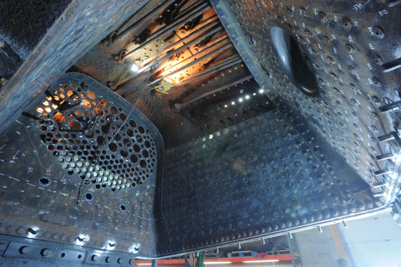

PostPosted: Sun Feb 02, 2014 7:12 pm
Posts: 704
Location: Anchorage, Alaska
Congratulations to Jeff and the 557 Mechanical Crew. After removing stays for quite a few weeks they hit another milestone yesterday. The crown sheet is now on the floor behind the locomotive. The volunteers added an extra day to their normal four-day-per-week schedule and had the additional help of Art from Fairbanks for a few days. A wide-angle view of the results.
Dick
