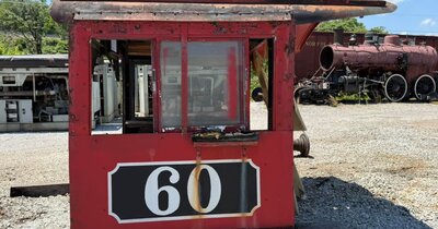

- Great Western (Black River & Western) 60 class 2-8-0 #60 has just gone down for her 1472 SDI.

SteamEnthusiast4000 wrote:
- San Antonio & Aransas Pass E-40 class 4-4-0 #60 should be further evaluated (and hopefully have her boiler ultrasounded) along with the newly acquired 2-truck Shay Oregon, Pacific & Eastern RR #112. {Personally, I hope I can see #60 operate in the not-so-distant future.} [Thanks RookieFireman]
https://www.facebook.com/SARHMinc/posts ... gcPYhWcdVl
"San Antonio Railroad Heritage Museum
Yesterday 2:02PM
Now for the moment you all have been waiting for!!!!
SARHM is excited to announce, we have entered into an agreement with the Gulf & Ohio Railroad to acquire the LAST remaining San Antonio & Aransas Pass Railroad locomotive, the SA&AP #60!!!
This has been years in the waiting! We had been negotiating with the Stone Mountain Memorial Association prior to being sold to the G&O. When the locomotive was sold off, we never gave up hope that we could one day return the SA&AP 60 home to Texas and her home rails! Today, that dream has finally come to the point where it will become a reality!
With Scott Lindsay’s experienced eyes on site today, we did an initial survey of the locomotive and its condition. It definitely needs some serious work, but as Scott said, it’s all relative. In addition to worn out parts and missing parts, we will be putting together a plan of attack for the restoration plan….
Oh yes, we WILL be restoring her to operation!!!
The main, GLARING, issue we found was with the outer firebox wrap. The metal is thinned in several places, sever pitting, case iron rigid stay bolts, NO flexible stay bolts…. Yes, you read that right, no flexible stay bolts. For those that don’t know, that is the reason she was removed from steam operations at Stone Mountain in the early 90’s. We don’t know the full details, other than what Mr. Kevin Wood who worked on her at that time told us, that during the rebuild at that time, someone decided to replace the flexible stays with rigid stays. This is an immediate violation and can lead to a VERY catastrophic event occurring! There are also some extremely poor previous boiler patches on the firebox, that just will not pass inspection.
In the coming weeks, we will be posting more detailed photos (we’ve got a SD card full) where we will discuss other issues and repairs that will be needed. We will also be discussing our plan for the phases of restoration. For now, we are going to start with getting the Baldwin boiler diagrams and such to make a comprehensive restoration plan.
We will be launching a page on our website in the coming week with a dedicated donation button for this project!
WE ARE SO EXCITED ABOUT THIS!!!! IT’S A DREAM COME TRUE!!!!
