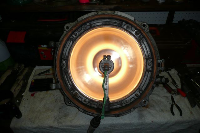

Thank you very much to everyone who has helped with tips and ideas for replacing a missing and broken lens reflector in our headlight! After researching this forum and getting some great help both on here and through the Locomotive fraternity, I was able to come up with a solution using a stainless steel bowl that is a perfect fit! Please see attached picture.
