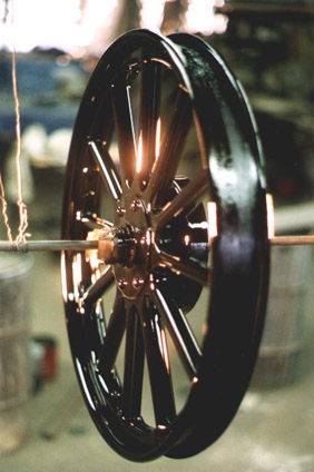

Here's a picture of a much smaller object, but one with lots of problem surfaces. This finish is Concept, somewhat very akin to Imron. Flow out on this was helped by cool weather, and I could turn the wheel to stop runs--can't do that with a locomotive!

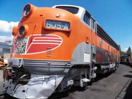

I found some pics I took in 2017 of 805A and 2001, mind you I painted these in the 1990s, so they have weathered some, but the finish is (I think) still good.
And a close up of the "wing"

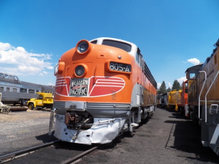

And now the 2001, undergoing some servicing at the time; note the front outside corner of the cab, that was my "start-stop" point, also note the curves on the nose; those were good places to "blend the "going around" first coat and top coat. (is this clear as mud??

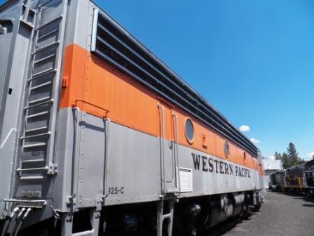

And as for painting outside, this B unit was prepped and painted outside.
