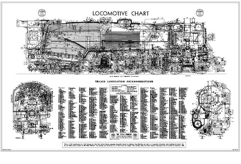

Texaco had a hudson locomotive that had the parts numbered and stated which lubes were used at various location. I have one put need to get it scanned. Found on etsy https://www.etsy.com/listing/520438693/texaco-lubrication-chart-of-a-new-yorkImage

When you get to that item on etsy, click on the seller's name (LocomotiveCharts) -- there are many different examples of locomotive, each with its own callouts. (That includes a GG1 for you electric fans...)
It is possible that the original could be duplicated at full size (about 4' x 6') and in the original color -- there are sellers making nine-foot posters out of Big Boy builder's photos and blueprints, after all -- and that would be something to see.

The original 'poster' as found on etsy was as noted originally produced by Texaco at larger size. These might now be public domain; the person providing the 'reprints' is going to comment here on the various charts' provenance.

[quote="Mike Tillger"]Texaco had a hudson locomotive that had the parts numbered and stated which lubes were used at various location. I have one put need to get it scanned. Found on etsy https://www.etsy.com/listing/520438693/texaco-lubrication-chart-of-a-new-york
I started making locomotive charts back in the early 1990's. My father, who worked in the Railway Sales Division of Texaco for over 30 years, acquired an original Texaco Locomotive Chart in the 1980's and tried to find a way to reproduce it to sell copies of it. Unfortunately, the only method available to make copies was photography, which was too expensive. At the time I got involved, hand scanners were the newest computer gadget available. I did some research and found this approach was not feasible. I also found a company that could scan a drawing and convert the scan into a vector map CAD file. I had the chart scanned and spent the next 16 months redrawing the scan in AutoCad on my little 286 clone. After the drawing was done, I spent another few months adding the parts list and part numbers to the drawing. I took the finished chart to toy train shows and everyone thought it was great, but most asked "Do you have one of the Big Boy?" Not knowing what the Big Boy was at the time, I went home and did some research.
While at one of the trains shows, I found a vendor who was selling Train Shed Cyclopedias. He had one with an vintage article and drawings of the Big Boy. I had the drawings scanned and on my 486 clone, it took me three months to create the chart. The Big Boy chart was very popular and for a while, I even supplied copies to some museums that had Big Boys in their inventory.
Today, I can create a chart in about 4 to 5 weeks, depending how motivated I am. I have 30 different locomotives drawn, so far, and I have about 30 more waiting to be done. Train Shed Cyclopedias are my main source for locomotives, though I do find material from other sources. I recently found a Baldwin Locomotive Works Chart of a 4-8-2 locomotive on a website called Kansas Memory. They have an extensive collection of AT&SF pictures and drawings. Train Shed Cyclopedia #31 has two charts in it. One of a 2-8-2 Mikado and one of a 2-8-8-2 Mallet. I am currently waiting to hear from the Pa. State Archives on what drawings they have of several locomotives (electric and steam) from the PRR. There are many sources for material, but they can be hard to find.
