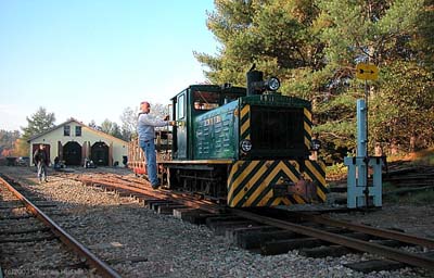

Bright and early Friday morning at 7 a.m., I joined about 15 others at the museum. After loading all sorts of track tools and materials, we climbed aboard #118, a genuine WW&F flatcar, and were shoved out to the end of track by diesel loco #52. We were preceded by Brookville gas loco #51 pushing a small, steel, heavy-duty pushcar. After unloading the tools, we turned to loading ties onto the pushcar.
Steve Zuppa and Fred Morse use WW&F Ry #52 (Plymouth 1961) to assemble the day's work train. The enginehouse and machine shop can be seen in the background.

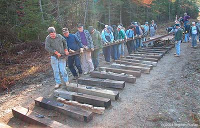

The WW&F track guys have devised an excellent method for extending the track in 150-foot cycles. Sixteen to 18 people lined up next to the rail on the right side of the pushcar. On the command “To the edge of the car,” all hands slid the rail to the edge of the car. The next command was “Lift,” and with 32 to 36 sets of hands and muscles lifting, moving a 560-pound rail was relatively easy. “North,” barked the crew leader, and everyone carried the rail along the push car. As they reached the end of the rail on the ties, the leader, who was the last man on the rail, counted down the distance. Then, “east” toward the gauge of the track, “down” onto the ties, and finally”south” to bump the rail against the previous rail.
The crew then moved to the opposite side of the push car and repeated the procedure. Meantime, a couple of workers had already swarmed to the rail joints, putting on the joint bars and quickly slipping bolts through the holes and spinning lock washers and nuts into place. A few quick turns of a wrench and the joints were together. (A brief digression is necessary here: the two-gauge railways in Maine were mostly built with their rail joints opposite, rather than staggered as in standard gauge practice. I’m told this is to prevent “oscillation” or rocking of the rolling stock on the narrow track as the trucks hit the joints. In any case, it does make track construction a little easier.)

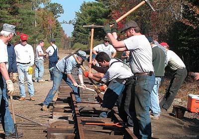

When five rails per side, or 150 feet of track, had been laid on the ties, the cart was rolled back out of the way, and several groups of volunteers grabbed spike mauls and began driving spikes to hold the line rail in place. Just as soon as the line rail was spiked down, track gauges appeared and the field rail was spiked into place. We had the first 150 feet of track in place by 9 a.m. The pushcar, now emptied of rail, was taken back to be loaded with ties.
James Patten (foreground) displays his knack for effortlessly driving spikes. Swinging the mauls with equal skill behind James are Jason Lamontagne and Rick Sisson.

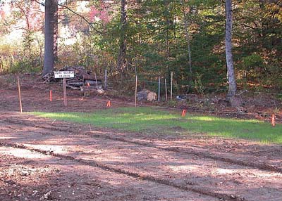

As the track pushed north from the former end of track, the wait for ties or rail became longer, and there was plenty of time to chat with other volunteers. Some of us took the opportunity to walk north to the end of the graded right of way, admiring the fresh grass planted at the site of the station at Alna Centre. A sign announced to all that the station had been located here.
Sign located on the former site of the Alna Center station, and grass freshly planted by museum member Fred Morse.

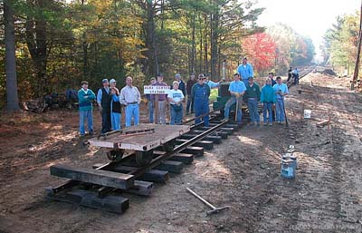

Saturday morning, we were hard at it again. Each train that arrived from Sheepscot discharged a few more volunteers, and a check of the log book at the end of the day revealed that 53 people had worked track. There were probably more than that, but some folks didn’t sign in. By Saturday night, we had built another 720 feet, bringing us to Alna Centre. Someone observed that when engine 51 arrived with the last load of ties, it was the first time a train had been at that site in 70 years.
Sunday morning's early-bird crew briefly poses for photos before taking a break for coffee and chocolate milk.

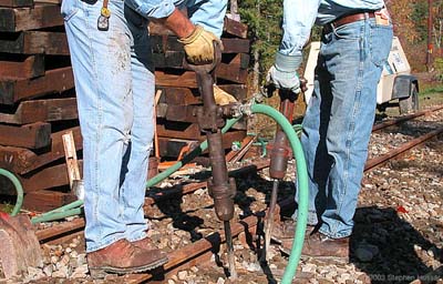

In one its few concessions to 20th century railroading, the WW&F had decided to allow the use of power tamping equipment. Since no one knew of a two-foot gauge tamper, hand-held pneumatic units known as “jitterbugs” were used. However, all lining and jacking was still done the old-fashioned way.
Air-powered Jitterbug tampers in use on the curve to Trask crossing.
Ballast was hauled to the site on the flatcar, just as in days of old, and everyone set upon the car with shovels, shoveling the stone off and throwing it between the ties or piling it at the ends of the ties. As the track was filled up, the flatcar was moved ahead. It was hard work, but with a large crowd, we were able to empty the flatcar in 15 minutes. Depending on how much the track had to be raised, sometimes we had to fill the track two or three times.
By late Sunday afternoon, it had started to rain, and many of us were pretty tuckered out, so this work didn’t proceed as rapidly as we had hoped. We did get all the lining and raising done, but only got about 150 feet of track tamped.
