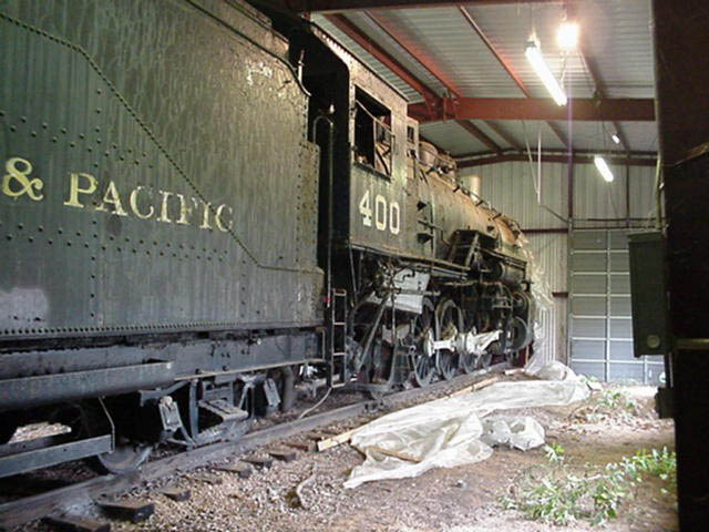

After many years of outdoor storage, and little upkeep, the discovery of asbestos emerging from beneath a rotted jacket coincided with the advent of public concern about asbestos, and a steel building was erected over the locomotive to protect the public from asbestos. It was a beautiful structure for its purpose, having plenty of room on either side of the locomotive and big bay doors for access, but from the outside was not visually stimulating.

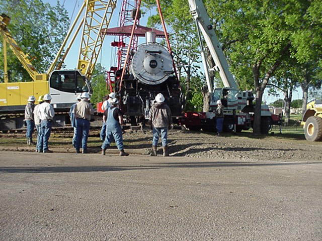

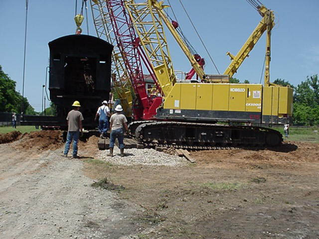

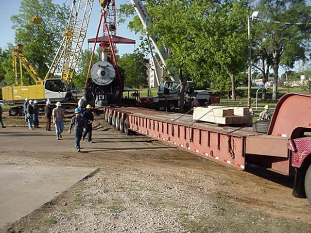

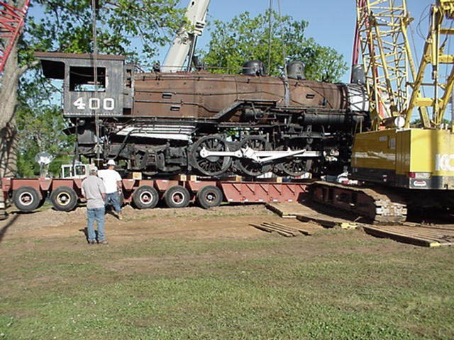

Upon arrival in Marshall on Friday May 2, I go directly to the park. A large crew from Fowler Transport is on hand with some gorgeous cranes, support equipment, and tackle. They hadn't been advised of my involvement, but adapted quickly and welcomed my advice. The plan was to set up and make a test lift, then on Saturday grade a path over the curb to the front of the locomotive, lift it up, haul out the panel of track beneath it, back the rig in, crib and secure the load on the lowboy, and park the rig on the street for a Sunday move around town.
Fowler is probably the best, most professional rigging contractor it has ever been my pleasure to work with. They have fine equipment, work well as an organic team, are extremely safety conscious, and readily adapt to changing conditions effectively.

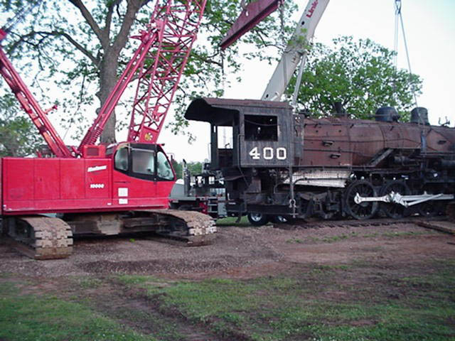

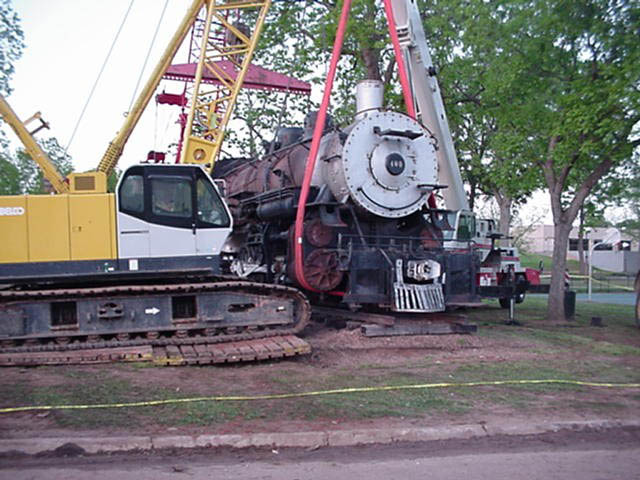

One such change was in making the hookup for the lift. They had welded a beam under the frame beneath the cab, and planned to lift the middle and front with the boiler. None of the Depot Museum people were aware that the only rigid connection between the frame and boiler was at the smokebox, the bottom of which showed obviously visible signs of metal rot. Lifting as planned risked tearing the smokebox from the saddle. They were also unaware that the rear and front trucks needed to be secured to the frame before lifting.
We ran into a problem with the lifting tackle being lighter than the lifting capacity of the cranes. Fowler's crew readily solved this problem by using 3 cranes, with the stress carefully controlled among them all, to execute a perfect, safe lift once the lifting slings were placed properly under the frames such that the front truck would be supported, and the rear truck chained to the frame.
There was also some confusion about the weight of the engine. I had underestimated it at 180,000. The riggers had been told 300,000. It actually weighed 240,000 as lifted. I have had a chance to do more research since, and found the spec engine weight to be 272,200, which given the loss of some material and no water and supplies on board, seems reasonable to me.
So, we had a good plan, and were properly rigged by late Friday to load on Saturday morning.
Breaking Free

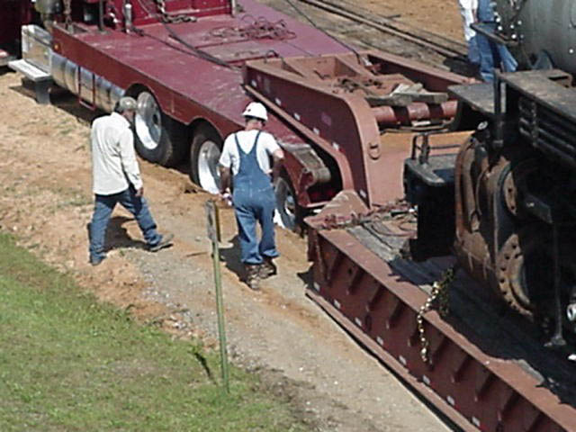

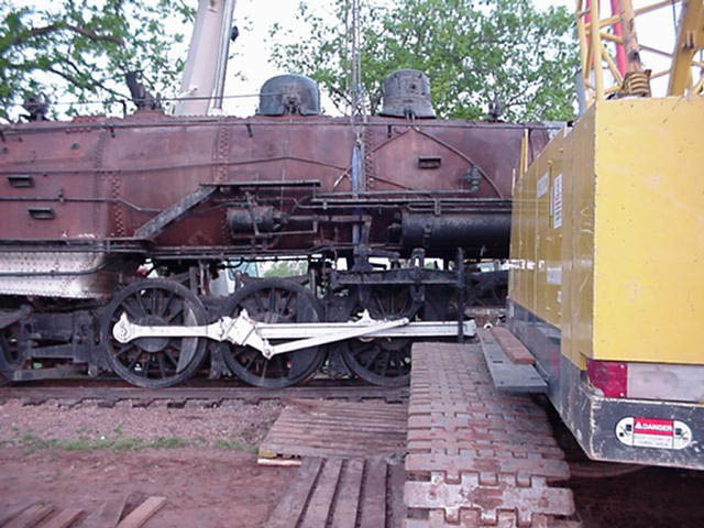

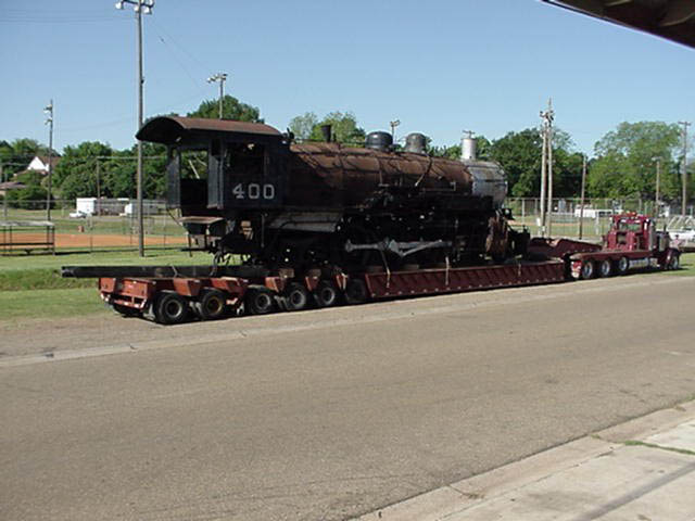

Saturday's load went like clockwork thanks to Fowler's crew. The trucker had determined that the load would be cribbed with oak timbers underneath the brake beams - not how a railroader would have done it. The brake beams are supported by pins, and they are known to move - in fact, if the brake beams don't move they can't apply the brakes. Supporting the majority of the weight on the bake beams risked breaking pins or the load shifting under the stress of a quick stop or a sloping road. Unfortunately, we had no other option, so it was cribbed that way and cinched down with some extra stout binders. Fortunately, nothing broke or shifted during Sunday's trip around town.
One surprise encountered during the lift was the almost effortless breaking loose of the drivers to roll. One of the slings was run through the spokes of a driver to ease the possible crimp the frame would have put in it, and the wheels rotated about 6 inches when slack was taken up. The locomotive is in better mechanical shape that it appears.
On the other hand, once set on the cribbing on the lowboy, the drivers sat on the cellars and the boxes stayed up in the pedestals. It would have been easy to get some oil in the journals at this point if I had been aware of any planned rolling on its own wheels. I don't think there was any such plan at this point.........

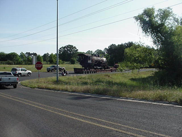

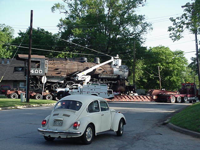

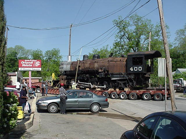

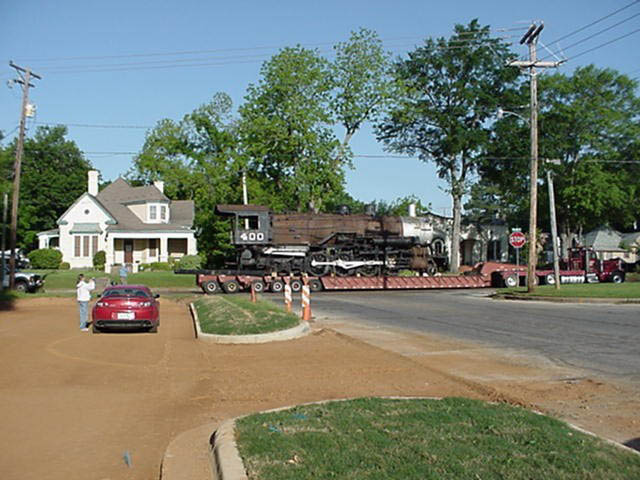

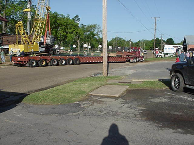

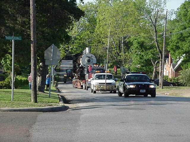

Sunday was absolutely gorgeous - a fine day to move a locomotive. My efforts were to go from potential trouble spot to potential trouble spot along the route, taking pictures and being available in case of trouble. The trucker was accompanied by representatives of the public utilities and city parks, including two bucket equipped line trucks, and every low wire was dealt with expeditiously. The last tight curve was negotiated to get into the yard, and we all breathed a sigh of relief.

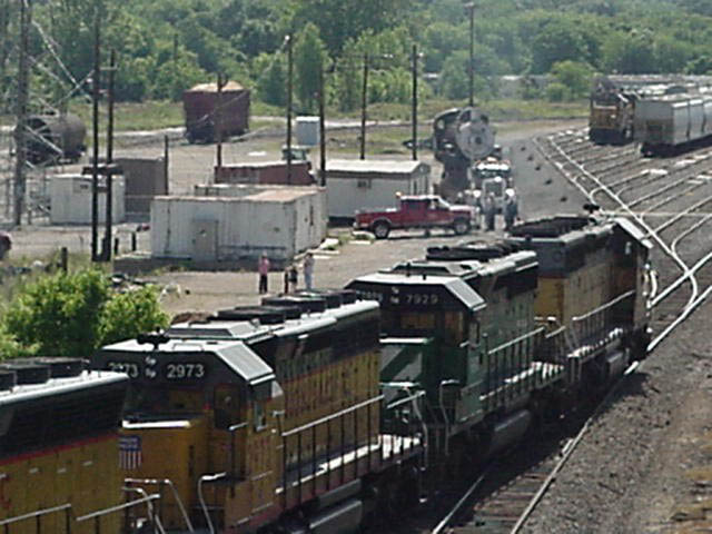

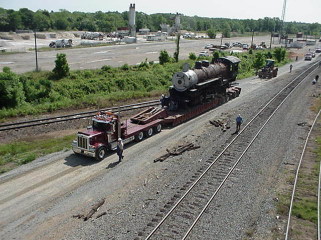

I got into a good position on the overpass to document the proceedings while UP ran two ballast trains across the leg of the wye we needed to cross. Finally, UP gave us clearance and we moved easily across the tracks and through the gate onto depot property.

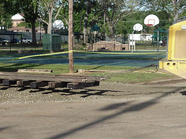

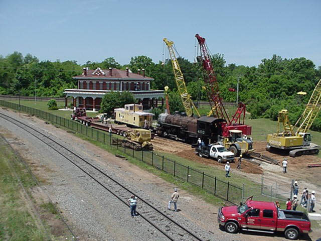

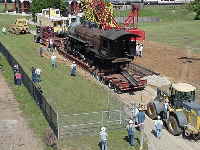

A new display track had been installed with the grade for the lowboy parallel to it to the south. 3 cranes were set up on ties on the display track. The unload would be done and then all 3 cranes would slowly creep back north of the track, then lower the locomotive into place. Or so it said in the fine print somewhere.

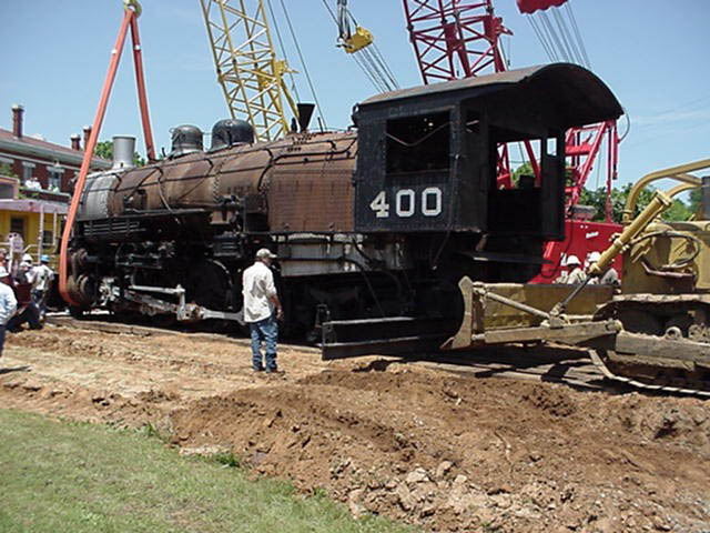

Well, whoever was in charge of site preparation didn't take soil load or compaction into consideration. As soon as the truck hit the new grade, it sank axle deep into the soft fill dirt and stalled. Fowler solved the problem by moving the cranes a bit, hooking to the locomotive, lifting some weight off the lowboy, and having a bulldozer drag the rig forward with its winch while the cranes pivoted along. Sure enough, the rear wheels also bogged down, leaving the locomotive about 10 feet east of where it needed to be.
At this point the decision was made to roll the locomotive the last 10 feet on its own wheels. I had no opportunity to lubricate the journals.

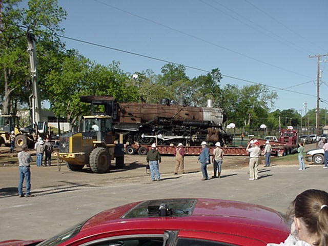

Fowler rigged for the unload just as we had rigged for the load, and easily set the locomotive down on the track as planned. Their large articulated forklift came in from behind to push the locomotive forward. It rolled well until the right side approached forward dead center, than stalled and the forklift lost traction. Moving the bulldozer in and shoving it with the drawbar finished the job nicely. Hopefully, the journals were not damaged significantly in the short slow roll. I am told that one of the lowboy axles broke when the weight was removed from the trailer - probably the only casualty of the soil problems, other than time lost to rig twice.
