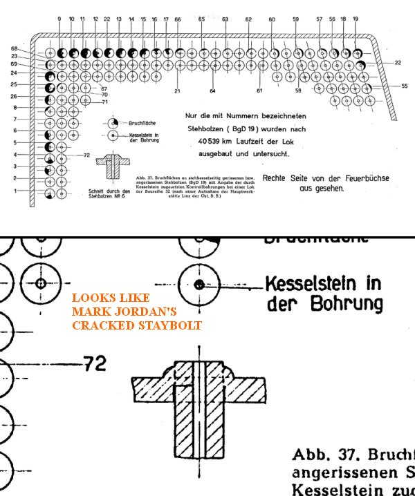

SEEMS LIKE Prof. TROSS WAS NOT TOO HAPPY WITH FILLET WELDED ROUND BAR STAYBOLTS
BgD 18 & 19 refers to 18 mm and 19 mm round steel bars
Boiler and boiler side refers to the wrapper sheet
Crosscut is equivalent to cross-section
