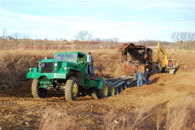

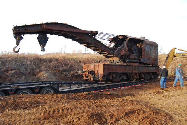

Not looking to steal anyone's thunder, but I've been holding these since Sunday 12/23, awaiting Gary's official mention of this project. On a visit to Roanoke two weeks ago, he said "You have to see this little project we've been working on." OK, says I.
It isn't every day that you can see the seemingly impossible happen right in front of you. "You're going to put THAT on THERE???" As Papa Boule said, "Watch me!"
The excavator gave a push and the truck winch did the pulling; at one point, the winch cable had to be re-set and the excavator boom/bucket held the crane 3/4 of the way up the ramp.
One of the amazing things here is that the little part of land the crane was on, was the original level of the surrounding area. The topography and constraints of this property and the sheer size and weight of the crane make this an extraordinary extraction job. I can't wait to see the rest of the move photos, and the crane back on the rails.

Howard, She dropped back down onto live rail about 2:00 this afternoon, with a dozer, the excavator, and a tow truck in attendance. You could almost hear a sigh of relief from that poor trailer. The crane is now on an unused siding over in the concrete plant, about 1/8 of a mile from where your pictures were taken.
