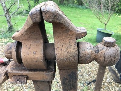

I have found the remains of an old railway truck under a very overgrown tree at the end of the garden where the platform remains, and digging around it I came across the item featured in the photos. Does anyone know what this is? I'm guessing it is railway related - it is very heavily built, has two vice jaws, and the handle is very worn in the hole where it sits. The odd thing is, the handle cannot be turned because it has a 'key' in a slot at the bottom of the hole which prevents it from rotating.

File comment: Close up of the item I found. It looks like a vice but the jaws cannot be wound open by the handle as you would expect as the handle cannot rotate at all.
File comment: The screwdriver blade in this photo points to where the key is that prevents the handle from rotating.
File comment: Another close up view of the item I found.
File comment: This is a photo of the item I found in an upright position, there is a spike extending down through the workbench which I guess used to be part of the mounting. There are three holes in a flange out the back of the item where it was probably bolted to a bench? The vice jaws have virtually no space in which to open...

It is a blacksmith's post vice. There should be a leaf spring to separate the jaws, there is a piece of it on yours under the clamp with the wedge retainer. The bracket screws to a bench top. The fixed jaw leg goes into a pocket in the floor. Makes for a very rugged vise. The key you see keeps the nut from turning. The screw is probably locked up.
Size of the vise is determined by the jaw length.

Would one of these have been found in a steam shop, and if so what would it have been used for? I could see it being useful for bending a long piece at its midpoint, say a hand rail or pipe of some sort.

The design uses the long lower 'lever arms' to increase the clamping force and eliminate the need for carefully-machined (and perhaps difficult to maintain) slideways for the movable jaw.

For sure, especially in earlier eras. Blacksmith's vises were commonly found in machine shops in the 19th century, prior to the advent of the parallel-jaw machinist's vise.
The great utility of a blacksmith's vise is that it's designed to be hammered on. The jaws are solid forgings, not castings, and the leg (typically set into a wooden block in the floor) holds it vertically rigid and transmits the force to the ground. This means you can pound away without causing damage.

It's a dead ringer for a well-used, well-abused, and probably-salvaged-ages-ago blacksmith vise in his shop.
