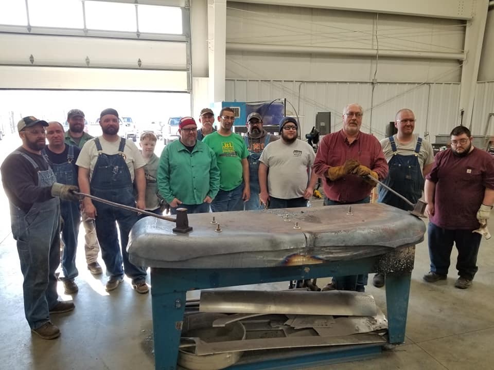

For those of you without Facebook, here are a few photos of the “heat and beat” get together

I really was impressed with the turn out, displays and presentation. I spoke with Jason Johnson, the T1 Trust GM after the presentation and he is extremely knowledgeable about the T1 and steam locomotives in general.
Someone from the SteamChannel youtube site was there video taping the presentation. They hope to publish it in next week. I told them I would post link here.
It was very cool to see so many different groups come together and come out and help form the backhead. There were guys there from 765, 1225, 2100, 11, 611, 2716, 576, 3 and I am sure others as well. RYPN moderator, Rick Rowlands was there beating on the plate as well. I didn't get a chance to talk with him.
The pictures don't do this boiler justice. It is huge.
Thanks to the T1 Trust for allowing us in to see how its made.

Could anybody put names to the faces in the group picture? I know some, but not all. Even with just those we do know, that’s quite a lineup of talent.
--Becky
 Post subject: Re: PRR T1 Trust Open House
PostPosted: Wed Mar 11, 2020 1:22 pm
Joined: Tue Jul 17, 2012 5:24 pm
Posts: 79
Becky, this was posted on another site and , I assume everyone is in same order
Jason Johnson (OCRR,T1 Trust), Neil ?(Everett RR), Nathaniel Watts (611), Rob Baughman (Hocking Valley), Ross Baughman, Rich Greter(SRI), Ed (Hocking Valley), Rick Rowlands (58), TJ Gaffney(SRI), Nick Hovey(Kentucky Steam), Gary Bensman(DRS), Zach Hall (765), Zach Tyler(SRI)
