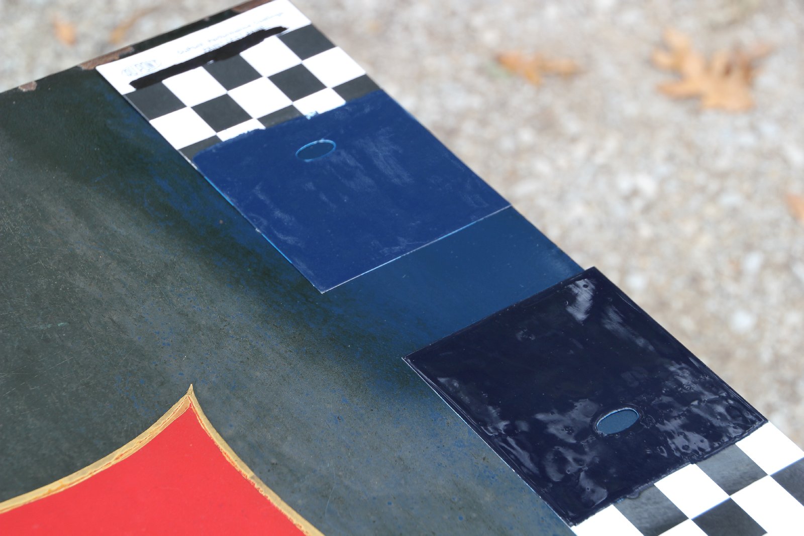

We do, however, have a Wabash heavyweight with original paint still on it. Sanding down through the layers, it has on it four different shades of blue.

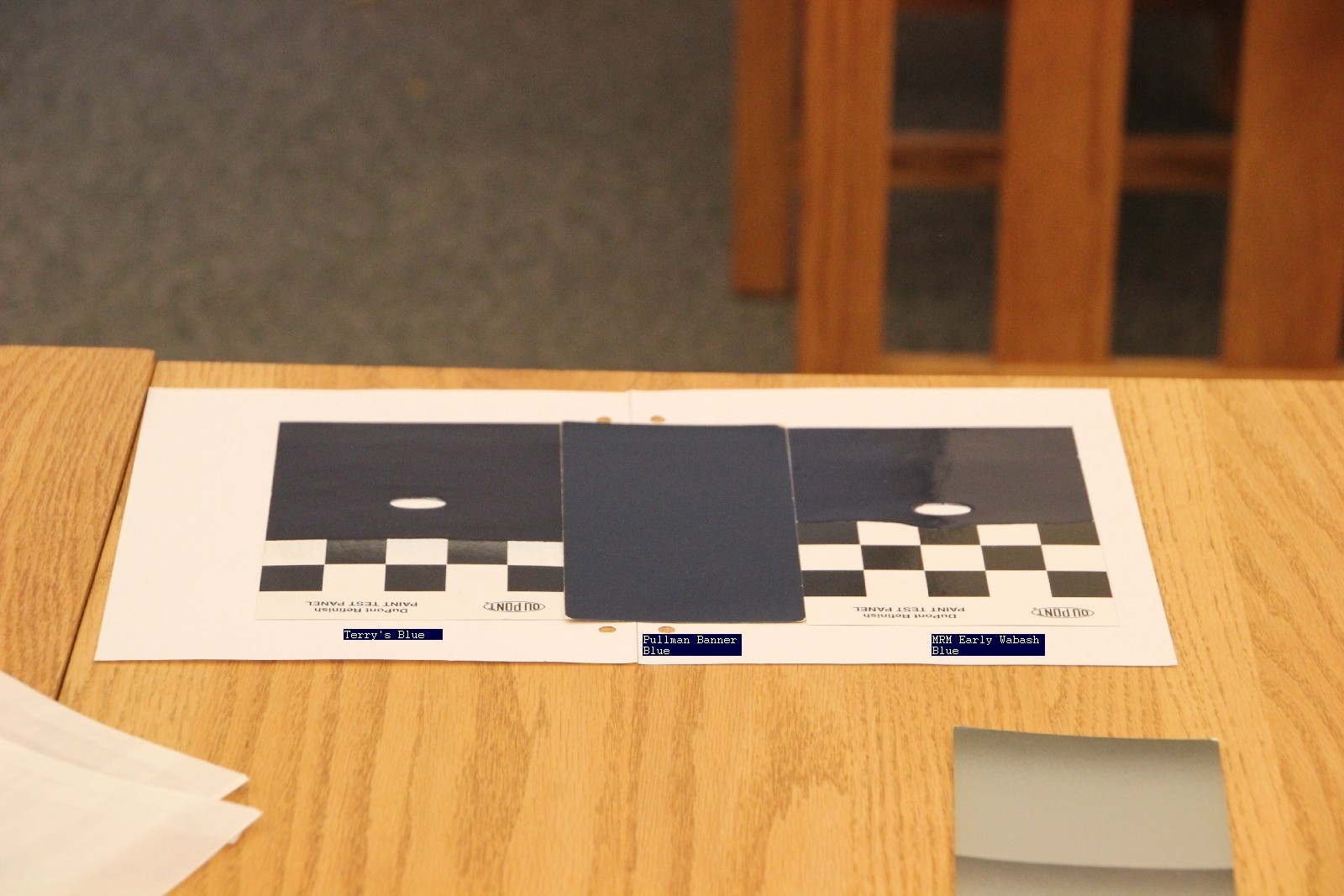

As noted by others, the Lincoln Library in Springfield, Illinois, has the Arthur Dubin collection, and in it are actual samples of paint from Pullman, with Wabash Banner Blue being one of them. It is very dark, and would likely match the really dark blue shown in the first photo in the sanded area of the end door. In comparing directly at the library, the dark blue we've used on our F7 is slightly lighter than the Pullman sample, and the Dark blue provided by Terry Schwartzwalder (as shown in the second photo) is a little too dark.
File comment: This photo shows original Pullman Banner Blue in the middle, with Monticello's F7 blue on the right, and the darker blue from Terry Schwartzwalder on the left. It was extremely difficult to get good photos in the library due to the lighting and lack of a non-reflective surface. But, suffice it to say that neither of the blues we brought to compare were not quite the same as the original, ours seeming slightly too light, and Terry's too dark.

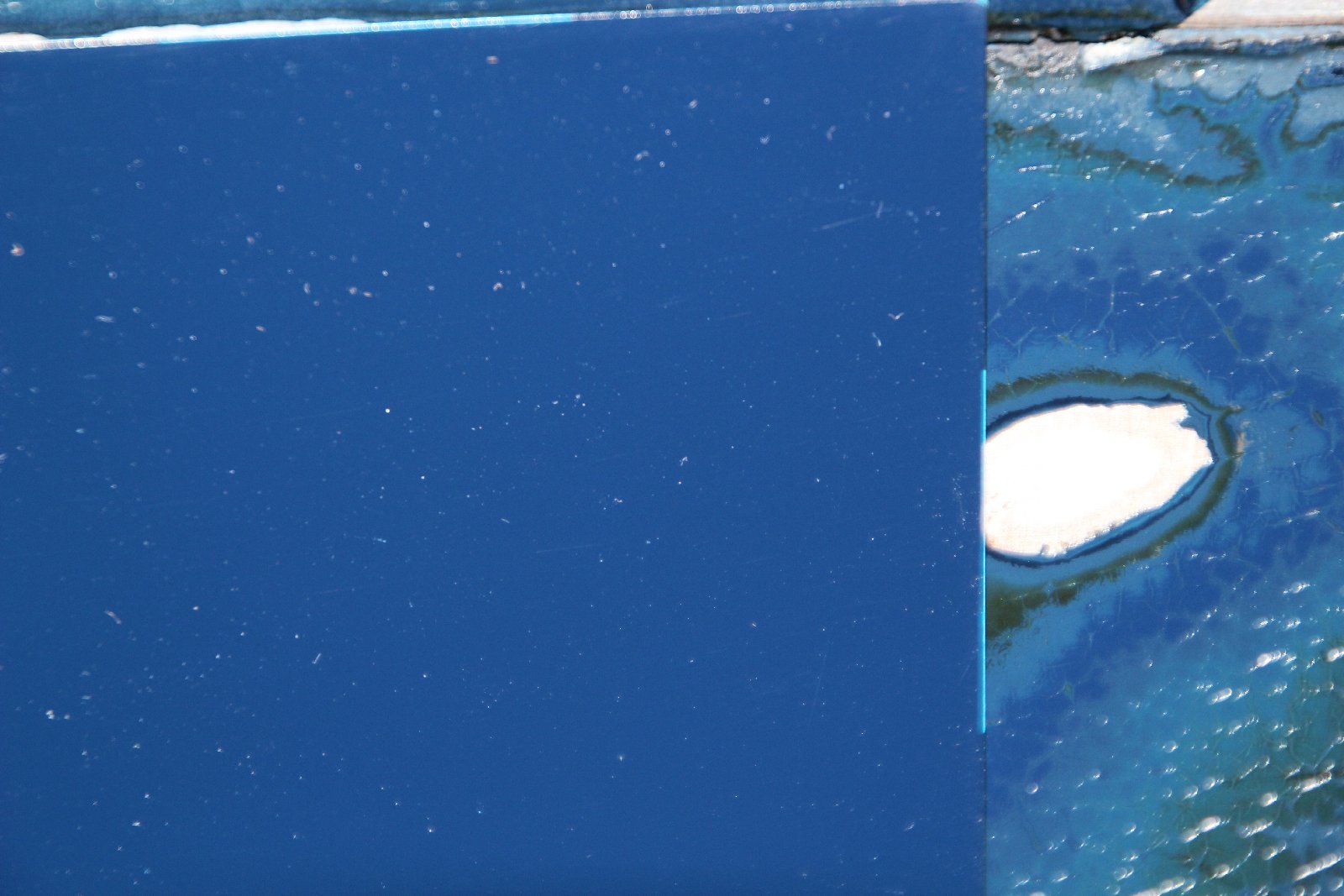

File comment: What you are seeing here is, on the left, a drift card of the same blue on 1189, and the NS Wabash heritage unit. The shiny spot is base metal of the car end door. Then there are the following: Light blue, DARK blue, light blue, varnish layer, more light blue, then dark blue that is near dead on for the drift card, then another layer of light blue, it topped with another coat of varnish.

 Post subject: Re: WABASH BLUE PAINT
PostPosted: Sat Jul 08, 2017 12:52 pm
What light source are you using to do those color comparisons at the library?
I hope not just overhead fluorescents, which might throw the color balance seen under 'normal' viewing conditions off.

Location: Monticello, IL
As I noted, the lighting there is terrible for comparing colors. Yes, nothing but harsh overhead fluorescents. The only way to really see the difference in photos was to look at them from that shallow angle. In all the direct overhead shots, they all look nearly the same. At any rate, we do have the pantone books, and at some point I'll try to get in there to see if there is a near match to one of the pantone colors. (If they'll let me bring them in... technically you can't have anything in there but a pencil and pad of paper.) Having them scanned with paint-matching scanners would also require special permission from their conservator, which I have not had the time to pursue.
PostPosted: Mon Jul 10, 2017 12:12 pm
The proper light for matching colors to be viewed outside is sunlight. Hopefully, the library has windows. Take the samples over to the window for comparison.
The biggest problem with matching colors under artificial light is metamerism:
https://en.wikipedia.org/wiki/Metamerism_(color)
Because of the difference between additive and subtractive pigments, colors that appear to match under some light sources look vastly different under others.
