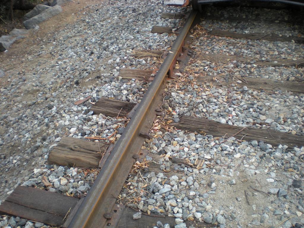

Sully: A drift fence might work if we were talking about a large amount of leaves. One of our guys just sent me this photo. The fire guy thinks this accumulation of leaves and twigs is a fire hazard. I can't think of anything that would prevent this, especially when 20 to 30 mph winds are not uncommon.
Has anyone else had problems with fire officials declaring this small "accumulation of dead vegetation" a fire hazard?

So, you get to rake up the entire right of way? To think I grumble about raking the yard. Man, I'm so glad I'm not in California!
Well, I do have a possible solution. Ugly but it may prove effective.
Once you get the right of way cleaned off, put down a layer of geotextile fabric on top of the ties and ballast. (Hopefully you can find one that the fire department won't say creates it's own fire hazard!)
Nail it to the ties with roofing nails or staples etc. The smooth surface of the fabric would provide a lot less places for the leaves to "key in" making sweeping them up less difficult. Cut it so that it curls up right against the web of the rail if possible. You may have to do a bit of folds to accomodate the curve, but it can be done.
I install fabric a lot, usually under the ballast. On occasions it's used on top with a layer of sand prior to paving the track structure. Of course that would be the ultimate solution, pave it to the top of the rails and the leaves would just blow away. So would all the funds in your budget, so it's not a viable option...
Fabric is relatively inexpesnive, and can easily be pulled up if you need access to the track structure.

Is this a local (mainly structural) fire department, or a wildland outfit like Cal Fire or the USFS? If it's a local district, maybe bring someone with more "real world" wildland fire experience in for a consult? If that photo of the guy with a leaf blower is typical of the problem it seems like a ridiculous attitude for a fire department.

It is our CalFire guy that is hassling us.

Kelly: The "real" railroad that operates on the same tracks is also getting hassled by the fire dept. Part of the problem is that we are in Yard Limits, on a curve, so running at restricted speed is 5 to 10 mph in that area. Talking to an AMTK guy who runs along the coast, he believes that the 70-80 mph speeds they run, keeps leaves blown away. Our slow speeds won't do it.
A few questions ...
First ... who exactly owns the tracks? Is it the museum, the "real" railroad, or someone else?
Second ... is the "real" railroad that operates over the line a common carrier under FRA jurisdiction?
Third ... does the museum fall under FRA jurisdiction?
The answers to these questions can have a significant influence on the course of action. If the tracks are owned by a common carrier under FRA jurisdiction, you can tell the local FD to go pound sand, and that the next time they trespass on the property they will be arrested, thanks to federal preemption. :-)

All joking aside, I'm certain they are considering those creosted timbers we call ties. They catch fire quite easily. A nice breeze and a little pile of those leaves combined with a spark could concievably do it. Probably not? Yes, I'd agree probably not, but fireman don't do "probably not" any better than FRA boiler inspectors do, all they know is "It could happen!"
If they have a valid concern, then trying to deal with is the best approach. If it's not valid, you'll need to find a way to prove it to them, and lots of luck with that. Telling them it's out of their jurisdiction, even if it is correct, will only lead to an adversarial position that would probably create more problems downstream. Is your station under their jurisdicition? Those stored cars? Your fuel supply? Shop, paints and chemicals? I'll bet an CA fire inspector with a bee in his bonnet could make life miserable.

Getting back to my initial question: is anyone else in this group required to keep their ROW as clean as has been mentioned? The photos shown earlier weren't clean enough. And if someone else is doing this, how do they do it?
I'll have to agree with Joe and Bob that yes, we have extreme fire danger in our area. And, I certainly don't want to be the conductor who has to say, "yes, it was my train that started the fire that burned 500 houses and cost 2.5 million to put out."
Certainly we have to make a good effort in trying to minimize the possibility of starting a fire. We can't have foot-high weeds growing between the rails, we can't have internal combustion engines running in the area without spark arresters, and we can't have people throwing cigarettes off the train. But there has to be some point where it can be said that we have done all that is practical to reduce the possibility of a fire. There is no way to reduce the chances of a fire to zero.

Could you rig a series of nozzles across the bottom of your locomotive's pilot aimed to blow debris out from the ballast and onto the bare earth shoulder? It could be run off the main reservoir as long as you can keep the flow low enough, or the duration of each pass short enough to avoid drawing down the pressure too far.
If you used such a blower on every trip, it might help prevent accumulation to the point where the labour- intensive leaf blower thing could be reduced to the odd trouble spot.
I haven't tied this, but it should be pretty easy and cheap to rig up as an experiment. Even a flattened bit of tube could serve as each nozzle.
Anything to reduce your labour requirements and satisfy the FD!

The requirement to remove every last vestige of plant material seems a bit extreme. A fine spray of water with every train sounds like the most effective mitigation measure. The concern for weed growth is legitimate but could probably be dealt with by use of a pre-emergent herbicide. Several of these are registered for use in California, including some fairly promising new ones.

If removal of leaves seems impractical, what about a smoke chaser. This could be an effective early warning method and have some limited capacity to fight a fire. This would be enhanced by radio responce directly to the FD or to an emergency dispatcher, even a member at your base station with a land line to the CFD/911 operator. How is your cell phone coverage in the area? Does the CFD have a ROW map with MPs? Do you have a tank car that could be kept full at a spot accessable to CFD vehicles? I'm sure these issues have all been discussed amoung yourselves and the CFD. Keep working at it. Make it a win/win.
