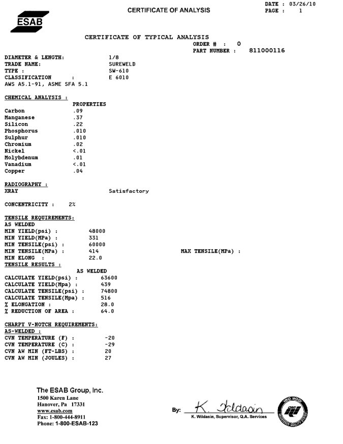

Uhhh, John,
According to ESAB your 7018 super rod has 88,000 psi TS and 75,400 psi YS.
The ESAB 6010 has 74,800 psi TS and 63,600 psi YS.
(see ESAB certifications below)

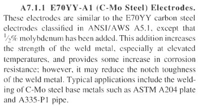

ASME Section IIC, SFA-5.5
A-1 means it has 0.5% molybdenum added.
H4 means the rod produces an average diffusible hydrogen content of not more that "4"mL/100g of deposited metal.
R means the rod has been exposed to 80F temp at 80% relative humidity for 9 hours and still passed the H4 test.

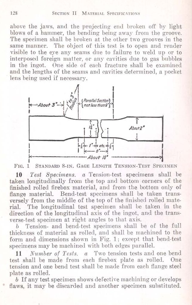

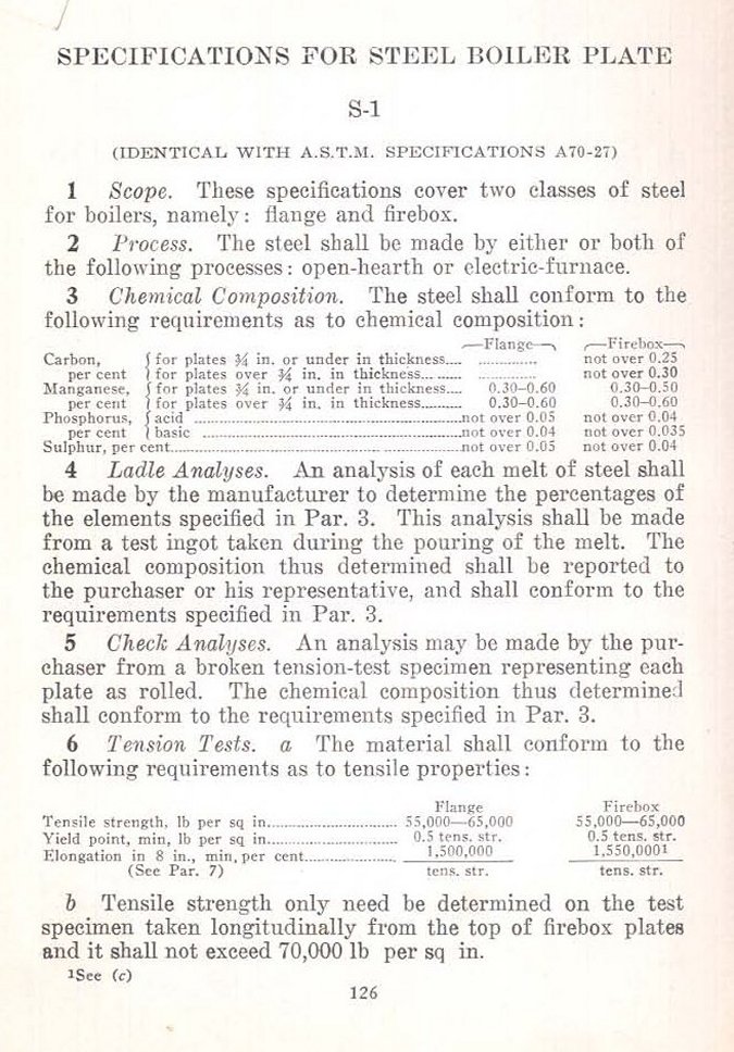

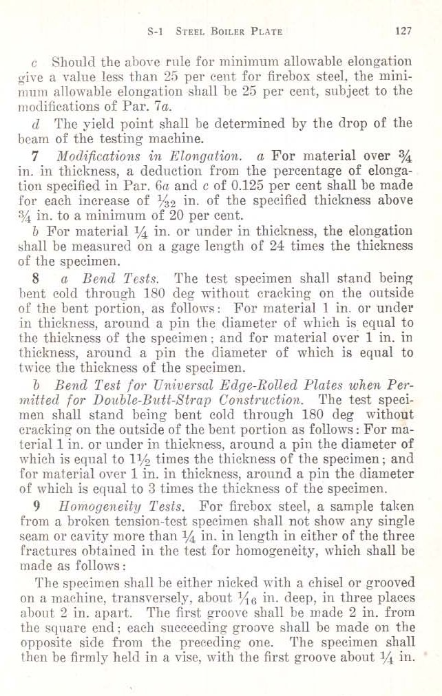

This is the Specification S-1 from the ASME Section II 1935 edition.
Grades are seperated into Flange and Firebox quality.
Notice the main difference is a tighter specification on the Manganese, Phosphorous and Sulphur content and also more rigorous mechanical tests for the Firebox quality.
Elongation is expected to be greater than 25%
Condolences for Mr. Gillespie.
