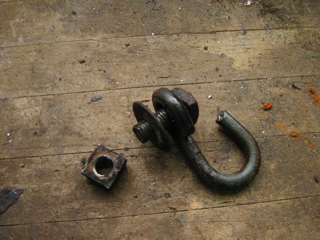

 Post subject: Re: Preservation or Restoration?
PostPosted: Thu Feb 09, 2012 8:35 pm
Posts: 179
Location: Utah

I would consider the work on 223 a restoration for several reasons... you are replacing the deteriorated parts in kind. I applaud you choosing to rivet rather than weld up the new tender cistern. I noted that you were choosing to replace the smoke box piping with cast rather than wielded replacements. This is the difference with rebuilding an artifact vs rebuilding a locomotive for tourist service.
A second thought, much of the work you are doing would be considered maintenance "in the day." Think of re-roofing or repainting a historic building... this is not restoration, it is maintenance, the roof and paint being examples of wearing parts.
One other thought... document the work you are doing... particularly why you chose to follow the path you are... for example why you riveted the tank, how you riveted the tank... this documentation should become part of the artifact's record.
