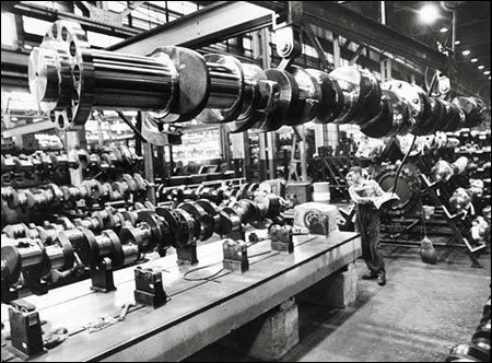

One of my favorite memories of working at Forge was going through the polishing room, where there were multiple machines turning shiny huge crankshafts in medium-speed spinning lathes unlike anything I've ever seen.
One of the attractions of steam has always been that you could 'see' it working. That could be done here as well. I've always thought that one of the best applications for a badly worn crank and prime mover in a railroad museum setting would be to cut it down so it could be displayed as a moving artifact, maybe no more than 100 rpm or so, spinning in the bearings, powered by an electric motor. Most people have never seen an automotive crank, let alone anything this big. It would be one of those memorable displays that would not be easily forgotten.
Nothing against steam, but I'll just never forget those SD45 crankshafts! I'm almost sure this shot was taken at Forge. http://i1279.photobucket.com/albums/y52 ... 676896.jpg
