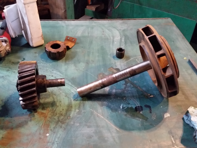

We found another problem today after doing some running with it. It seems that the key holding the gear to the pump shaft sheared. I just happened to open up the compartment door and noticed that the pump shaft was not turning. So I'll pull it off next week and check to see if there is any damage to the shaft and/or gear.
The pump packing is also leaking more than it should (yes I know it leaks a little but should not be a steady stream) and I'll repack it then as well.

It turns out that it was not a sheared key, but a completely snapped shaft causing the problems. The pump shaft is made with a sharp 90 degree shoulder which caused a stress riser that snapped the shaft in two.
So, while the pump is out to replace the shaft I'm also going to replace the oil seals, packing rings and pump bushing. Basically rebuild the entire pump.

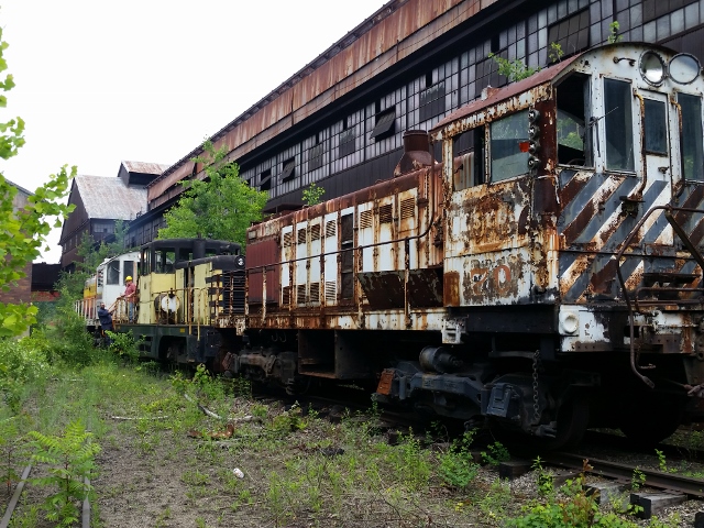

We just had to get a shot of the three locomotives together. USS 70, the "parts" Alco, G&W 20, which will be going to Lake Shore and the 777. This is the first movement over this siding in about 15 years. I have some journal polishing to do before I can move the 70, but I do want to bring it out and try to get the prime mover freed up and running.

We own both the 70 and the 73. I am still evaluating our options for the 73, including the possibility of moving it along with the 80 tonner to the Lake Shore Railway Museum. 70 will remain on its siding, but will be painted, closed up and kept as a spare parts source for 73. I have no plans to make 70 operable again, except for the prime mover which I want to get running just so I know that I have a good 539 engine in reserve. Just in case...
Fortunately there is no pressure from the steel company to move the locomotive, so I'm not going to rush to any decisions. I would ideally like to find a strip of land somewhere in the valley with rail access that we could purchase and use as our facility for steel industry rail equipment.

McDonald Steel only needed one locomotive, and the 73 had been rewired while 70 had not been. So they kept 73 as the running unit and 70 for parts. Frank Vollhardt took photos of both units running at Ohio Works in 1981. Its stunning how 34 years later the loco that was kept inside looks great while 70 is a rolling wreck.
