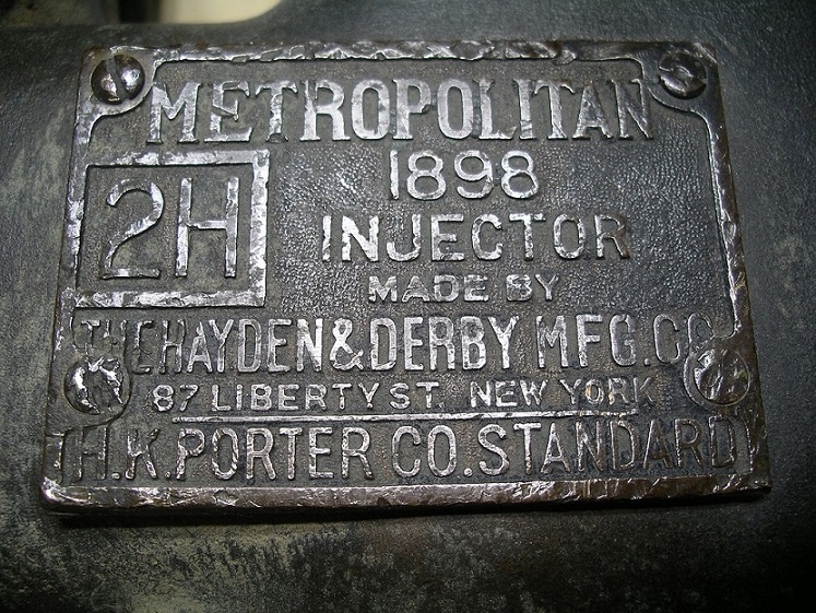

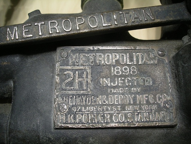

Porter 2H tag.

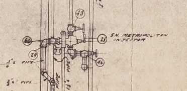

I am looking for info on a metropolitan injector size 5n. this was apparently used on a barn hart log loader. my intent is to construct a reasonable faxcimily for a model. I can scale my drawing but only have this one view.
File comment: snip from actual drawings.
