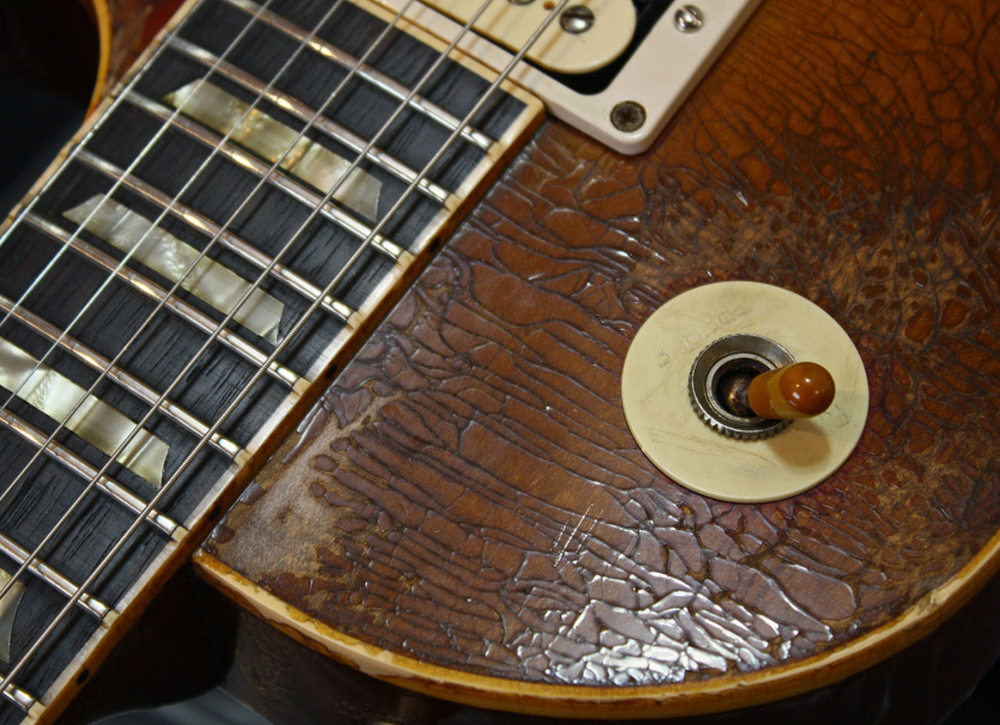

Guitar guys are somewhat nuts about getting nitrocellulose lacquer on their instruments. This is generally how it cracks up when applied to wooden surfaces, most likely due to constant humidity-related expansion and contraction...

You're correct on nitro finishes on wood with wide swings in temperature and humidity. Nitro never really absolutely cures depending on thickness. It cures from the outside in so it gasses off exponentially slower over time. Nitro on steel works as the steel expands less and doesn't absorb humidity. Some of my older guitars have nitro and they still look great as they've been well cared for though the finish does yellow/darken over time.
Back to the subject at hand, I wouldn't think they'd use nitro on the wood interiors of these cars but you'd never know unless you had it analyzed.

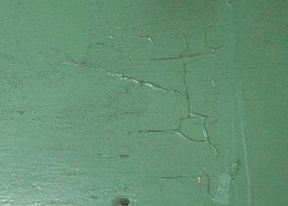

Hey, females and others are still painting their nails with it.
See how that paint is ridging along the edges of the cracks just like on the guitar, Eric? I'm wondering if that's an identifiable characteristic...

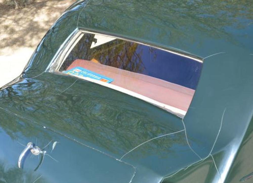

This is what nitrocellulose lacquer looks like when it splits apart on metal, caused more by physical and thermal stress and less by moisture, similar to the cracking as seen on the steel bulkheads of the civilian sleepers...

On the first image, IIRC, oil based paints are enamels. They'll do the same thing if any moisture gets into substrate so the blistering at cracks isn't necessarily an identifier for nitro. Actually, same with most paints and coatings.
As for the car image, I'd wager that cracking was due to an application and/or prep error. Typical nitro failure looks more like checking. As mentioned above about curing, the top surface is actually harder than what's underneath so the checking is usually just on the surface unless really severe and goes all the way through the finish.
