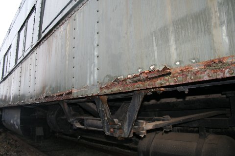

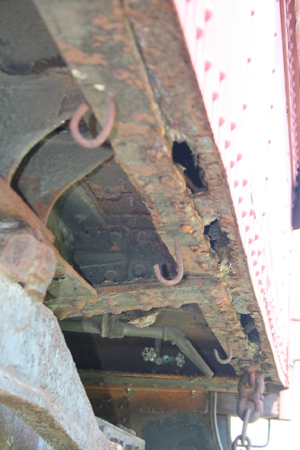

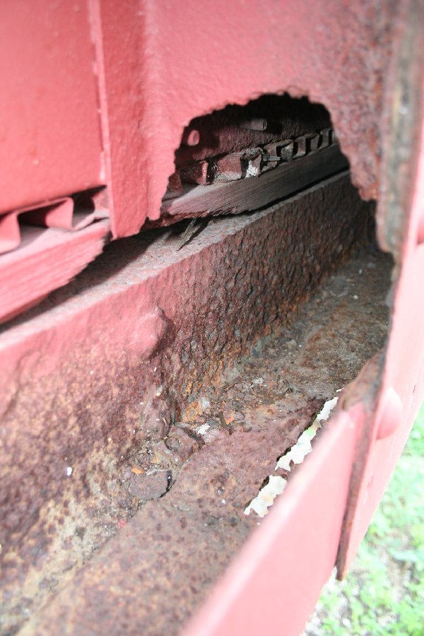

After reading the most recent discussion on the demise of the Queen Mary, I re-read Tom's question about corrosion... where it starts and where it goes .. and thought about it...and thought I might offer a few things.... with a few photographs to substantiate what happens....

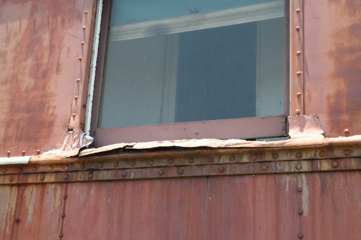

In many years of dealing with a few heavyweights, its safe to say the places of greatest concern ( obviously ) are the roof, and the window/belt rail area. The roof seems rather obvious, as like a home, it requires a barrier against moisture. Mechanical fasteners that hold roof sheets together, generally seem to have a greater failure rate then applications where the seams are welded together. However there have been plenty of welded seam roof applications, that say due to sandblasting have failed. Lack of maintenance ( once again ) causes it to happen....
A more complex method of corrosion is through either the windows and or the belt rail. Windows and belt rails vary based upon age of car, modernization etc etc, however no matter if it is a wood sash window or aluminum sash window where the rubber gaskets fail, water falls behind the side sheets, behind the belt rail and down the side sheet to the bottom side sill... ( see photographs )... typically the insulation in the outer walls get wet, and stays wet with the very bottom ( touching the sill) likely always being wet. The photographs show this condition with the insulation removed.

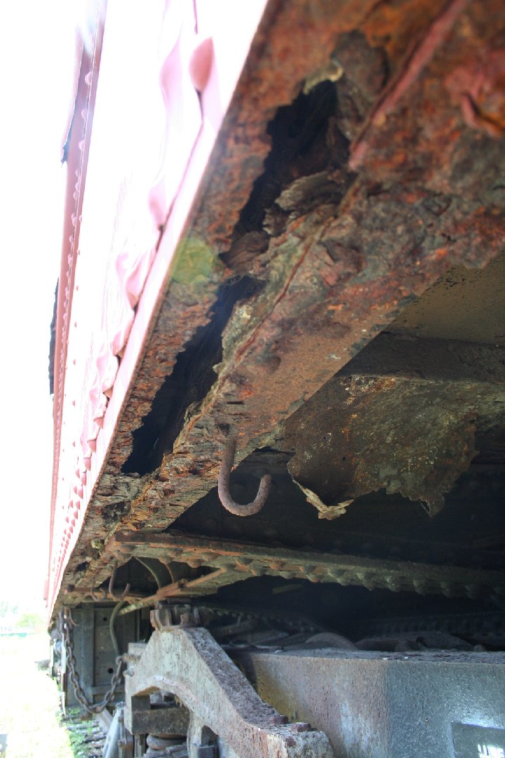

What then happens is the vertical support for the car ( below the belt rail ) rots out at the point of connection ( where it attaches to the bottom horizontal sill and the structure is then compromised ( see photographs )... Also the side sheet itself normally shows corrosion at the bottom of the sheet, as the insulation tends to stay damp at the bottom...
However there has been plenty of occasions where the sill looks to the eye intact, however its not until you remove a portion of the side sheet, that you see it is no longer providing any support other than the side sheet rivets are keeping it in place... It should be noted, that almost all heavyweights that return to private operation in Amtrak service, have had side sheet panels removed to expose conditions that normally cannot be seen without steel being removed....In every case, Amtrak requires a structural engineer to provide signed and sealed drawings for repair ( all outlined in Amtrak's SMP )
I provide a few photographs from CNJ car 97 merely to illustrate the significant points of corrosion, as, at this location, the side sheet were removed ( and never replaced ) ... and it illustrates this condition very well....

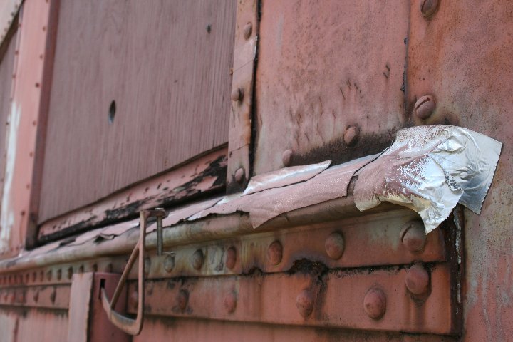

I once knew a gentleman who would travel the country with foil tape and chimney flashing... doing repairs on cars no matter the condition... Foil tape was intended to cover the rust holes and be a barrier of moisture... Jury is still out how that worked for him....

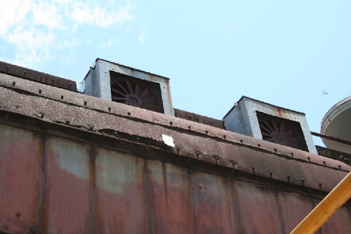

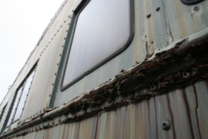

In addition, here are the conditions that lead to the problems on this particular car.
This would include the lack of any care to the roof, windows and belt rail.

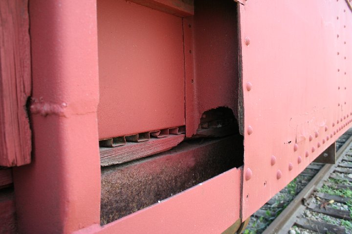

In conclusion, it all leads to this complete failure of the side sills and vertical supports. A common problem but one that few heavyweights can recover from....
