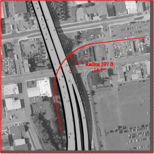

397 ft radius =
14.5 degree curve which =
the exact radius of a standard gauge 6-1/2 turnout.

Assuming all this information is indeed accurate, I absolutely HAVE to ask what someone was snorting/smoking/drinking when they thought a Reading T1 could routinely tackle that curve.
Comments have been made about the Reading's 2.6% Locust Summit Grade and 3.3% grades on some of their "main lines"; I just pulled out the photos, and the 2.6% Locust Summit grade was a more-or-less ramrod-straight inclined plane, worked with T1's fore and aft on freight!
Mr, Rowland, are you inclined to tell us how sharp the curves were on Sand Patch and Seventeen-Mile Grade? (Actually, don't bother; I can look them up myself.) And in those cases, there was a nice chance to gain speed before hitting the bottom of the grade, even with the photo stop south of Hyndman..............

Mr. Mitchell asks an interesting question, the answer to which I did not commit to memory. If you can dig it up I'd appreciate your posting same. What I do know is that we took a 13 car train plus an aux. tender up 17 mile grade(twice I think??) and it was the hardest pull I've ever personally run a steam engine. We spent a lot of the grade doing 10-12 mph with her on the feather,with booster,sanders and rail washers going full bore!!! I believe our trailing tonnage totaled 815 tons. She never slipped a wheel and there was never any doubt that she'd make it once she "settled down" to her sweet speed. I believe we had dry rail both times. As for Sand Patch we took the whole Chessie Steam Special consist over that grade a number of times(23 cars about 1395 trailing tons) again with all systems (sanders, booster&rail washers) to the max. and of course full boiler pressure(240 psi). I would guess that the sharpest curve(s) on 17 mile were somewhere around 11 degrees and the sharpest on Sand Patch about 9 degrees???
The sharp curve at the base of the 3.5% grade out of Tacoma certainly makes that a harder challenge but it only really means that in that situation she'll actually climb to her "sweet speed" as she gets into the heart of the pull rather than decline to it which she would where getting a run at the base of the hill was possible.

My question is how are you getting your distance? I am sure the railroad must have track charts and I would be going by those.
That curve is at the base of the hill. In fact, about 1/3 of it is actually on a downgrade. Yes, it's difficult, but the real tough stuff comes later on up the hill, in the area of S curves.
I think that 2100 could pull the hill under the right conditions, without diesel helper. I'm certain she can do it with one, she proved it the other day, and did it from a standing start on the grade. So this certainly is possible.
Now whether folks will pay $50 each to ride it is a different question, but technically it does seem feasible...

The F40PH operating alone without the steam locomotive can start the six car train anywhere on the grade and only requires about 12% adhesion to do it.
In typical 18% adhesion conditions operating with the canteen, the diesel, and six coaches the 2100 should only have to generate about 24,000# TE (35% of the nominal 68,000 rating without booster) to counter the grade resistance if the F40PH is loading properly. The diesel can do the rest.
