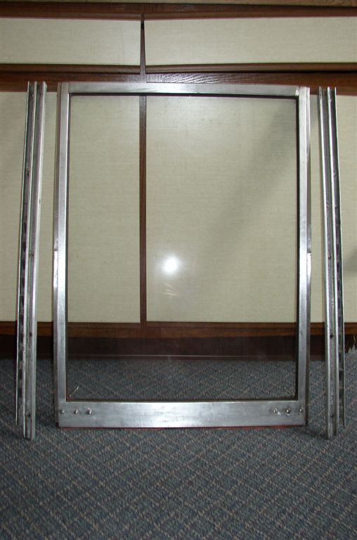

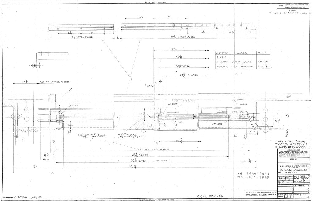

I have the drawings from Adlake, but they will be difficult to find, as they have been boxed up since 1987. I think they are complete enough to engineer, though.
I got them while I was general car foreman for Steamtown Foundation, and stopped by in Elkhart to visit Adlake. They gave me the drawings, but had no interest at the time in retooling to make those parts.
(I believe they are Model #25 sash, but my memory may fail me).
Steve
File comment: Almost, but not quite, the same window, being refurbished for a 1952 Decatur-built caboose
File comment: . . .and the print
