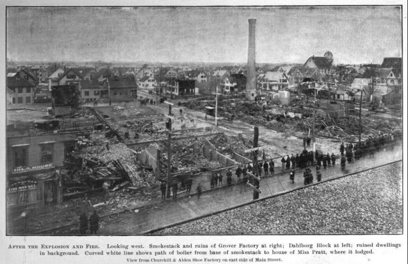

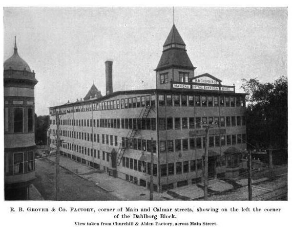

At a few minutes before eight o'clock, on the morning of March 20, 1905, a terrible boiler explosion occurred at Brockton, Mass., in the factory of R. B. Grover & Company, manufacturers of the Emerson shoe. The explosion and its effects were awful, beyond all description. The entire country was profoundly shocked, and Brockton itself was overwhelmed with horror and grief.

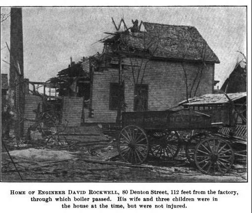

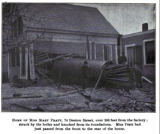

On Monday morning, March 20, without the slightest warning, boiler No. 2 exploded with extreme violence, destroying the boiler house, and also blowing down, instantly, the entire Denton Street wing of the main building, and a considerable part of the Calmar Street section. Fire broke out within a few minutes of the explosion, it being caused, in our opinion, the open gas jets which were necessarily used in the process of shoe manufacturing. The ruins burned fiercely, partly because the wood work was very dry, partly because of the escape of the gas, and of the naphtha that was used in the manufacturing processes, and partly (we are informed) because the floors were more or less saturated with oily matters. We do not desire to give the impression that the factory was regarded as a poor fire risk, however, for we understand that it was insured by the fire companies at a rather low rate, indicating that they did not anticipate any very serious fire. The building was also furnished with automatic sprinkling apparatus, but this, of course, was rendered useless by the breaking of the pipes, when the building fell. The entire building was quickly destroyed by the flames, including the "new building," which remained standing, as well as the part that was thrown down by the explosion.
