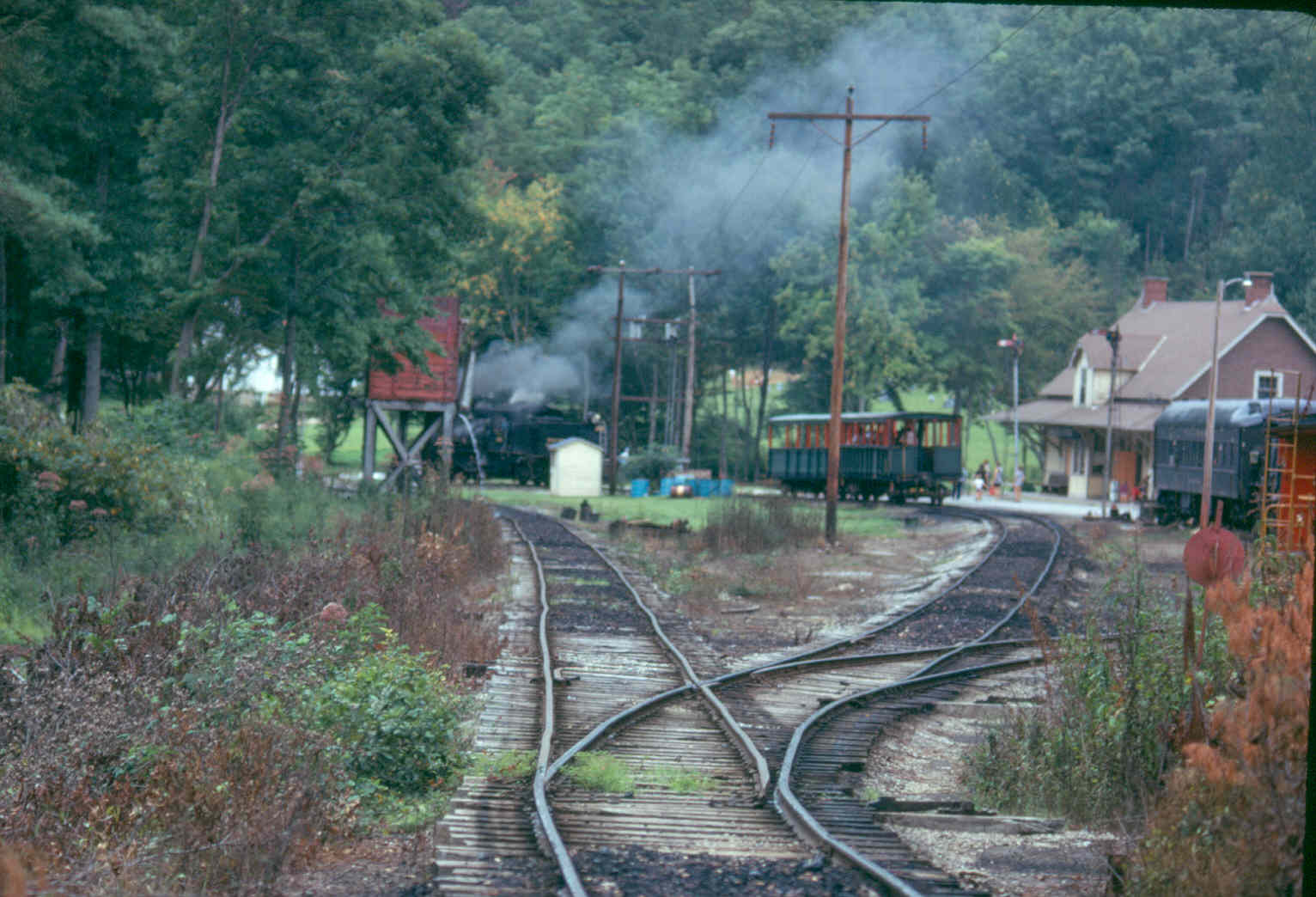

Certainly in the case of Graham County, the rail (or leading wheel) was kept wet to keep from having derailments, including on the so-called tangents. The rail was so badly kinked that on dry rail wheel flanges would ride up the side of the rail at a kink onto the rail head and derail, even at the very low speeds they ran. I seem to remember they had equipped the diesel with a watering system as well for the same reason. Once rail gets that badly kinked, it can no longer be lined into serviceable track. Talking to the crew at that time, they knew the only solution was all "new" rail, which was financially out of the question.

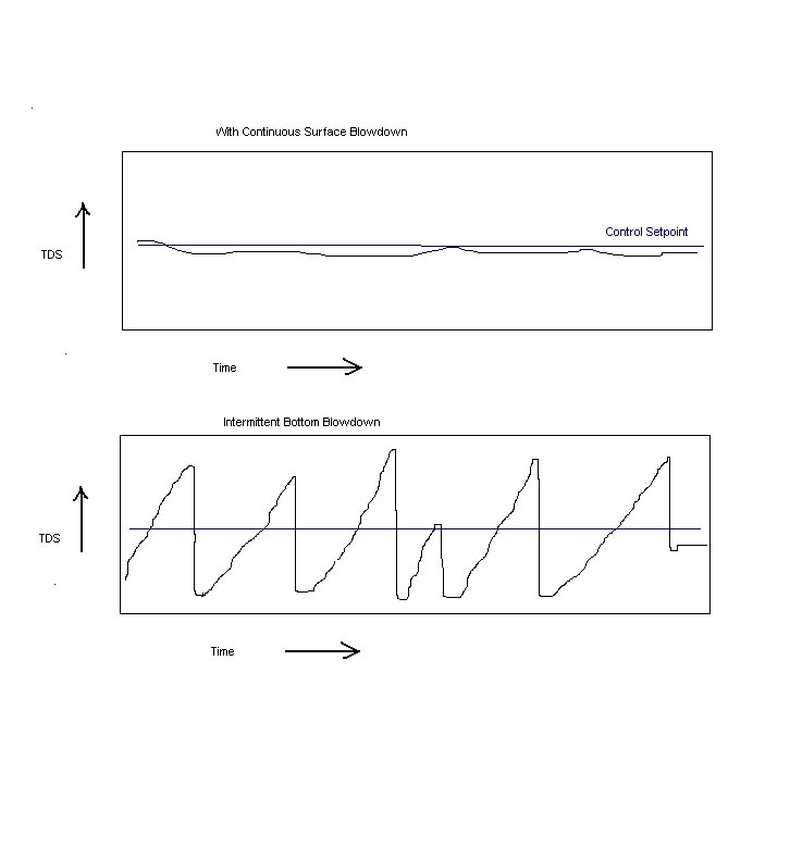

Realize that this is a 30" park train, but the physics and chemistry does scale up to 56 1/2"...The homebrew Shay at Rough and Tumble has a Surface Blowdown to keep the boiler water Total Dissolved Solids under control and avoid foaming and carryover. The tubing leads to the left hand railhead. This has the flange loading on the outside of the curves on a circular track. The improvement in rolling friction is noticeable with this trickle of water.

Jim, what are your thoughts on constant blow down on locomotives??
Dave
 Post subject: Boiler water Treatment
PostPosted: Wed Nov 17, 2010 3:17 pm
Joined: Fri Jul 20, 2007 7:31 pm
Posts: 138
Location: Elizabethtown,PA
Same as a ship, factory or power plant...it is the best way to control TDS.
See the graph curves sketched below.
Just like steam pressure and water level.
Railroading has enough shocks and surprises, without beating up the boiler ;-)
